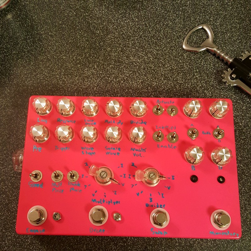

Well I labeled it and clear coated it.. It's in the oven curing..
Going to try to get all the stuff into it today. Only a little more wiring to do, not sure how to ground the C.V. jack..
- BetterOffShred
- Posts: 3412
Re: B.o.S. builds a .. robot fart machine
It's almost done .. this has certainly been the most wiring in anything I've built so far.

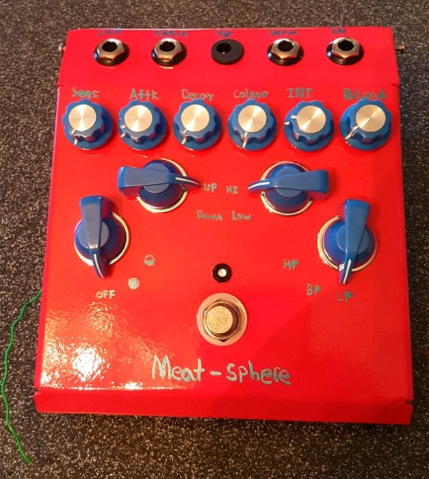

- Posts: 3412
Re: B.o.S. builds a .. moar builds
Finished the wiring on my Meatball clone. Taylor's board, eBay enclosure. It turned out pretty good. If anyone is thinking if making one, I recommend the NE5532 opamp despite the documentation requiring a LM1458. Mine sounded like dog shit with the 1458, and it really came alive once I swapped to the NE5532. That all being said, I also rolled my own vactrols using GL5528 photocells and 5mm green diffused LEDs. It has fantastic response and sounds like the videos to my ear.
