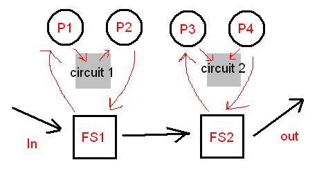

Still more questions... How do you combine 2 pedals?
I'm sure I can figure out the specific wiring myself once I get the idea, is this the general concept?
(Drew one of the arrows on the right backwards by accident)
modernage
Posts: 1937
Joined: Tue Jun 23, 2009 11:54 pm
Location: Nashville, TN
Re: More noob questions
Post by modernage »
Here's an example General Guitar Gadgets.
The easiest way to think about is this:
The wire from FX1 that would normally run from the 3pdt to the tip of output jack, and the wire from FX2 that would normally run from the tip of the input jack to the 3pdt will now be the same wire. It would be the same concept of having a patch cable between two pedals.
You will also have two wires running from the (+) of the DC jack to power each circuit.
