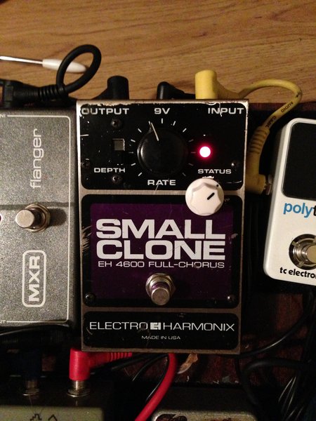

My first mod! :!!!: I changed the depth switch to a knobby and now the switch kills the dry signal so I can vibrato out all night. :yay:
There is one problem though. I need to add true bypass at some point because with the vibrato switch on, it kills the dry signal even in bypass. :lol: Oh well. I dig it!
The guys aren't really worth looking at. It's just moving wires around mostly.
