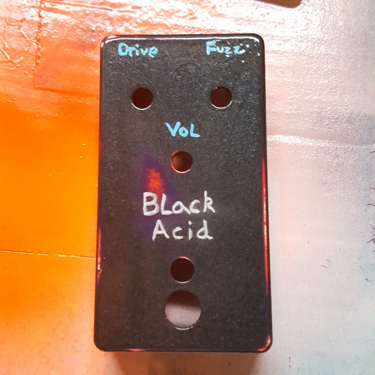

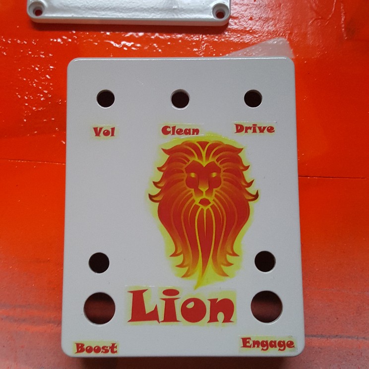

Well I quit soldering and painted a few enclosures. I did up my Black Acid enclosure, plus my "Shoelaser" and the Schumann Lion i finally got working. I Also painted the bottom plate for my PLL. Definitely going with hot pink.

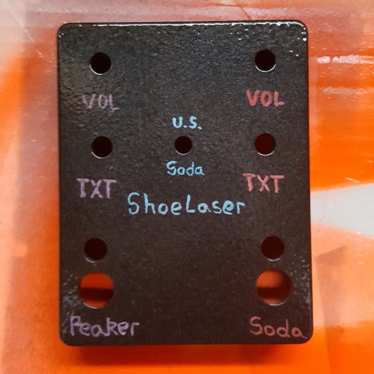

The shoelaser is just a soda meiser into a Torns peaked, and when I built my soda a year ago I built a transistor swapper for the last stage. It's a USA fuzz when it's oriented one way and a soda when you flip it, so it's on a toggle and I figured I'd include that functionality.

I've been painting multiple layers and then sanding through them a little to give it a weathered look. I'm pleased with its appearance

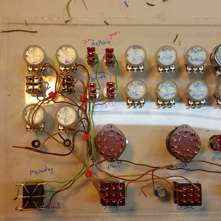

Well I got the drone and momentary stuff all wired up. Not the best wiring, but it could be worse.

I think on the actual box I'm going to move the 12 way selector closer together and closer to the middle.
Speaking of which, does anyone know how to put a "stop" in this style of rotary so it only goes to 8 or 9 positions? This one has 12 and it just keeps spinning all the way around.

Some types have a pin washer you can lift and twist and drop the pin into the slotted top to stop the rotation, some types don't. If you're able to spin it over 360 degrees I'm guessing you've got the latter.BetterOffShred wrote:does anyone know how to put a "stop" in this style of rotary so it only goes to 8 or 9 positions?

Thanks for looking. I thought it was the open frame variety but it's actually not. That's ok. I'll just leave it as is

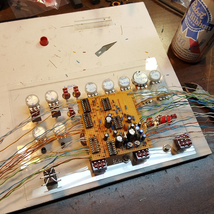

Well it's almost done.. Jesus it's a lot of wiring. Hopefully it'll be farting happily this weekend.
