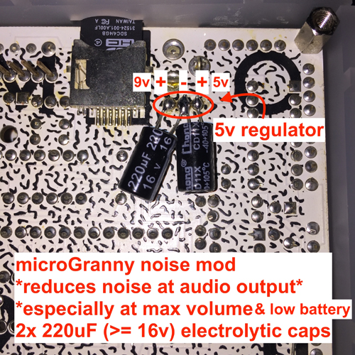

noticed that audio output from my micro granny gets really noise sometimes
decided to investigate so i opened her up.
by placing 2 larger caps on the in & out of the 5v regulator i was able to reduce the noise to almost nothing.
seems to be related to low voltage from the battery as this does not occur when plugged in via DC jack.
but i never use it plugged in tho.
the volts from my battery were like ~6.5v which i think the 5v regulator really likes something 7v or above to spit out a clean 5v signal
my 5v at the time was more like ~4.3v so thats how i came to my conclusion.
adding the caps, now my regulator spits out a healthy 5v! even at less than 7v from the battery

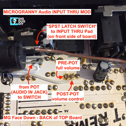

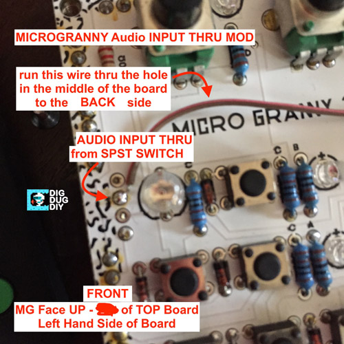

this one is adding an audio input thru so u can monitor what you are inputting. or use it like a passive mixer.
by using the input thru from the side connector and connecting it to the input jack (or input pot if u want volume control)
i put it on a switch b/c when u go to actually sample, it kinda messes w/ it if u turn on the recording monitor.
so u wanna be able to turn it off when sampling.
happy granny-ing y'all <#

Dr. Sherman Sticks M.D. wrote:if you're using the battery, has it been a long time since u changed it?
every time my granny starts acting up (never had that happen tho)
a fresh battery usually solves it.
This is exactly my experience. It's out of batteries now kinda and its acting very strange, but hooked up to a power cord it works perfectly.
And wow sherm, input audio monitoring is exactly what I need. Thanks dudeeeee

yea that always gets me. can't tell u how many times i thought my card was corrupted or bad.
or just something went seriously wrong.
nope just needed a fresh battery. all good again.
thanks yea! its a nice feature to have for sure.
the real thanks is to bastl tho for sharing their schematics
which made this a million times easier to figure out
