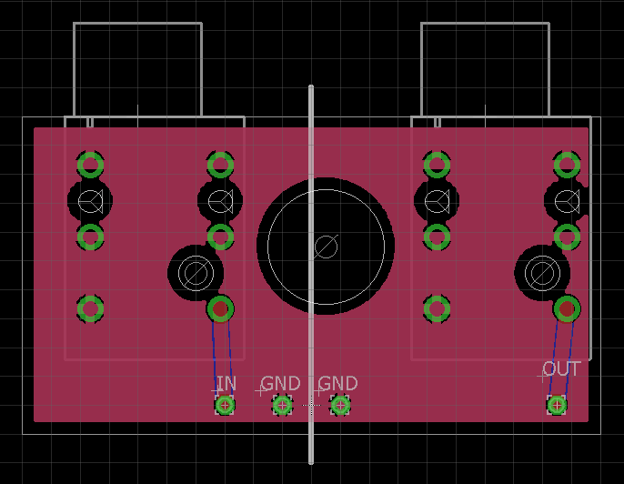

I designed a PCB to hold the jacks together. there is a hole in the PCB for a window to look at the power entry. This PCB makes it possible to clip the ends of the PCB mounted jacks. everything is very tight but it should be ok with this PCB and clipped leads. the line of symmetry is also marked for alignment as it relates to aesthetics of the build from the outside.
