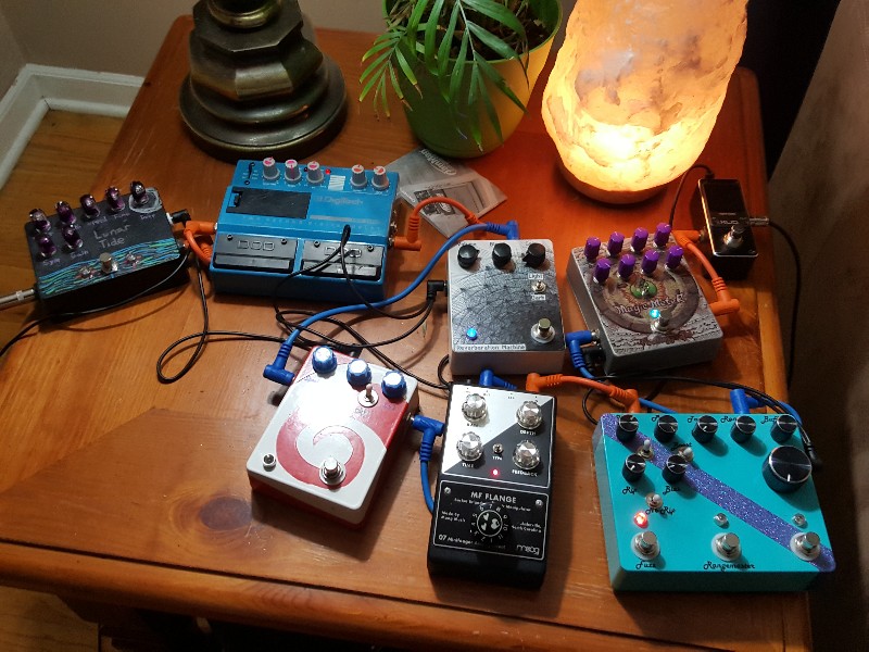

Magic meter --> Skyripper --> MF flange --> rebote 2.5 --> reverberation machine--> PDS1002 --> Tremulous Lune--> amp..
Good shit. The meter bumping the Skyripper is pretty dank.. it makes the fuzz so thick, makes just the rangemaster sound even more huge.. then modulation. Lots of fun
