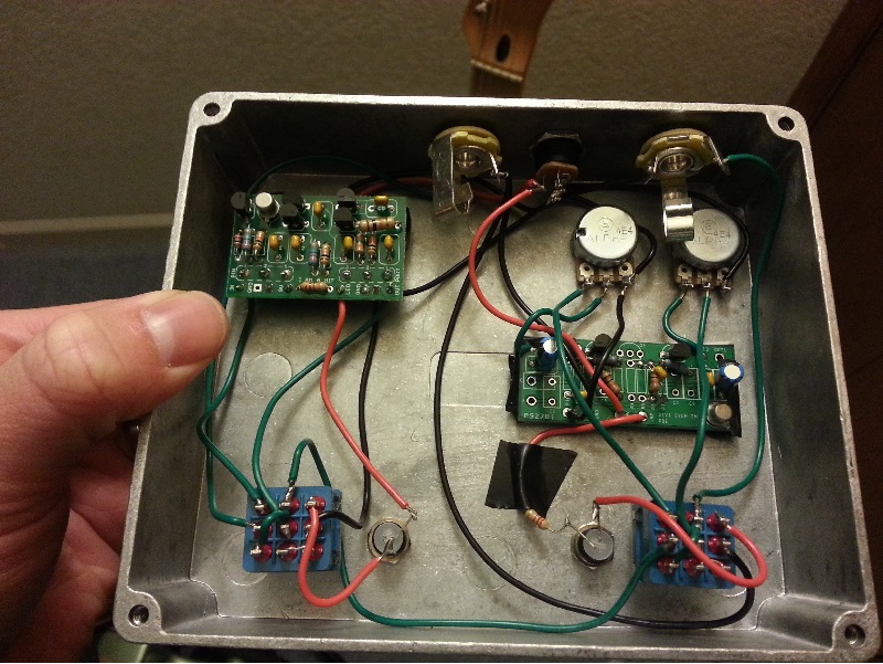

I'm working on a Bit,and apparently lost my R8, a 10k resistor. No big, i can find one, but i have on hand a 10k 1/2 watt resistor....aside from being huge, will this work? Change the sound? Or should i find a 1/4watt one like the rest of the circuit?

Alright. .who's got a Bit gut shot? I think i mounted my pots on the wrong side of the board (over the small parts )

Thanks Nocentelli I found a cold joint on one of the lugs of the bypass switch. I re-soldered it and my Hyperion is working great. Now I'm sorry I didn't buy a couple different pedals from the sale.

CyaNitrate wrote:I'm working on a Bit,and apparently lost my R8, a 10k resistor. No big, i can find one, but i have on hand a 10k 1/2 watt resistor....aside from being huge, will this work? Change the sound? Or should i find a 1/4watt one like the rest of the circuit?
It won't change the circuit at all, go ahead and use it.

CyaNitrate wrote:Alright. .who's got a Bit gut shot? I think i mounted my pots on the wrong side of the board (over the small parts )
The pots mount on the same side of the board that you soldered on. (the blank side with no components).

Thanks for the circuit help! Finished it up last night and it all works! It's the Bit into the Hyperion. It's been a while since I've played through Devi circuits(I know they're quirky) but I've never played through these two until now.. so two things:
-the Hyperion pre kills the signal when turned all the way down (counterclockwise)
-the Bit pre seens backwards...full counterclockwise is full-bore and it mellows as it goes clockwise
Normal?
In any case, it works. Now I get to tear it apart and finish the box with some awesome Borderlands graphics...will post when finished.

CyaNitrate wrote:Thanks for the circuit help! Finished it up last night and it all works! It's the Bit into the Hyperion. It's been a while since I've played through Devi circuits(I know they're quirky) but I've never played through these two until now.. so two things:
Normal?
For some reason the new Bit board is "designed" with a backwards texture pot. Dumb as hell. You could swap lugs 1 & 3 to fix that but its board mounted already so i wouldn't bother. Glad you got it sorted. Add a VFM and you have my DEFX trifecta.

Interesting...and kinda funny seeing as how I had the pots mounted backwards to begin with, but then the Volume would have been backwards. I understand the need/use for board mounted pots, but man are they a bitch to desolder... Much prefer solder lugs and running wire. And yes, I'd love another VFM, I had the circuit in a Rocket I had for a while, and enjoyed that side far more than the SM side.
