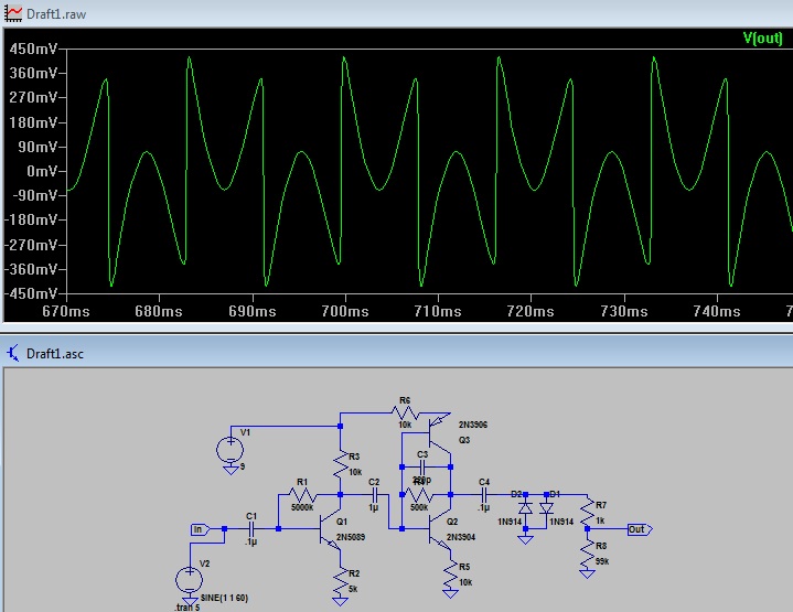

I don't know about any commercially available clones, but the schematic is out there, and it isn't too bad of a build. Just 30 seconds of googling found me this:
I threw that schem into LTSpice and modeled it, and it certainly looks like it's correct. The waveform shows crossover distortion, exactly as Zach describes.

greigoroth wrote:An even simpler build is Tim Escobodo's Triple Fuzz. The circuit was published long before the machine and apart from the 670 SHOs in the Machine, it's pretty similar. http://folkurban.com/Site/TrippleFuzz-708.html
Yes and no. It does the frequency tripler thing that the Machine does, but not the crossover distortion.

Can you chuck that into spice? I'd be really interested to see how it's waveform looks. I understand crossover dist - the machine output shows it beautifully! - but not really frequency trippling. ??

Sure, here ya go:
So it basically takes the top of both the positve and negative peaks and flips them, creating 3 peaks for ever 1 of the original. That's what's meant by frequency tripling. As you can see, it is very different from the waveform that the machine makes, but they both have 3 peaks for each one of the original.

Thanks dude, that is awesome!
