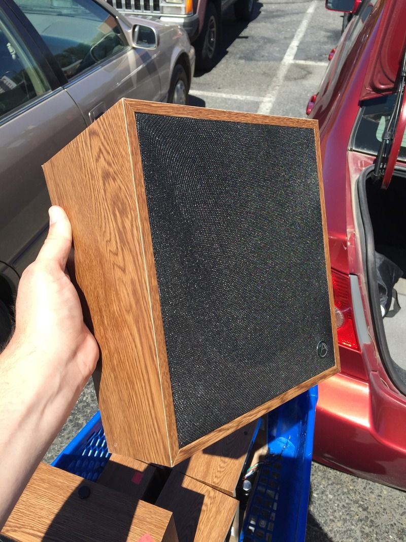

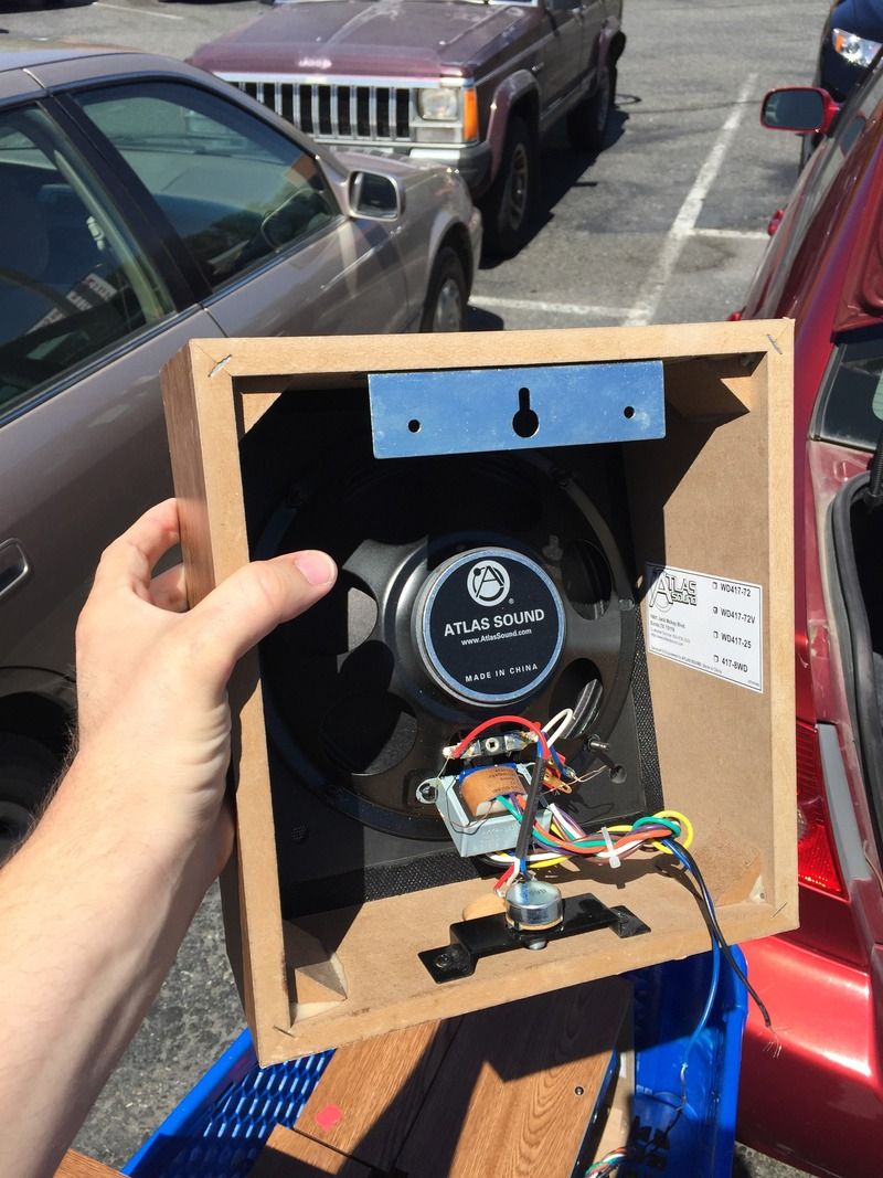

Shout out to resurrecting a four year old thread that I started because I am finally going to make a 6x8 cab! I just picked up six school intercom/PA speakers that have 8 inch speakers that should work great. Speakers are 8 ohm, 50hz-15khz freq range, rated at 96db at 1w/1m. To make the whole cab 8 ohms though will take some sort of funny wiring: two speakers in parallel (8+8=4) which will then be in series with a single speaker (4+8=12). Then the other three speakers will be in series (8+8+8=24) and then the two sets will be in parallel (12+24=8 ohms)!
