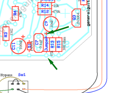

I just built one of these and added the Mids pot.
If you're using a GGG fabricated circuit board (e.g., one you ordered from GGG), there is a super-easy way to add the extra pot.
What the mod does is add a pot between C7 (100nF) and ground. That's it. And the GGG board is already set up to allow this, with one minor modification. The fabbed boards have the "jumper" spots connected on the top side with copper traces. It's hard to see at first, but those traces are there, so there's no need to actually add a jumper.
But, we want to break the connection between C7 and ground, and there is a trace making this connection. So the first step is to cut that trace to break the connection. Use the continuity test function on your DMM to verify that the trace has been severed.
With that done, it's simply a matter of using the jumper spot's pads to connect the Mids pot. One pad goes to lug 3, the other goes to lug 1. Then connect lug 3 and lug 2 with a short piece of wire.
Done.
Below is an image of the relevant portion of the layout, with the two jumper pads mentioned above pointed out.
Done.

Try a 5k
