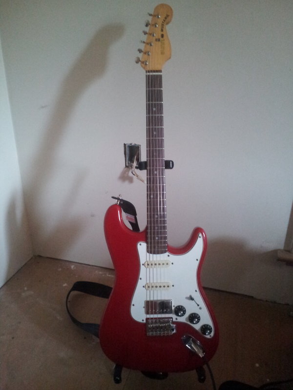

Finished up my Sunn O)))caster today. Kinda a pain in the ass as not even import parts fit this thing.
Bought it cheap and pretty much stock outside of a recent fret job and a bone nut. Made the following upgrades...
- wilkinson vintage tuners
- steel saddles (these needed grinded down to accommodate 50mm string spacing.
- schaller strap locks
- cts 250k pots w/ sprague 192p .1 cap, crl 5 way switch, switchcraft jack
- seymour duncan distortion in the bridge, stock bucker blew goats for pennies, but really like the high output single coils.
-fender blacktop strat knobs
Not too many of these sunn mustangs stateside as they were released for the european market. Basically a relabled indian made squire II that was only manufactured from 89'-90'.
No plywood here, solid two piece indian mahogany body that weighs a ton, maple neck, and the nicest indian rosewood board I've seen.
Great gee-tar and would recommend anyone to grab an indian made squire II/sunn if found cheap, the lumber alone is top notch, but like most budget guitars, the electronics and hardware can use some changing.
