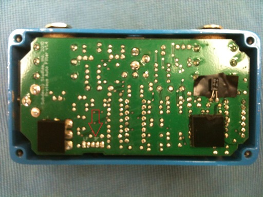

hey, digging this up as this is the only talk I found about that internal switch. I opened mine (which I purchased from Subdecay directly and late 2013, so after you), but I don't know where that switch is. There's only the back of the PCB, and it's "stuck" or at least fixed well enough that it makes me afraid of pulling it and destroying everything... any idea?
The first batch don't have that switch... But 2013, I guess it should be there.

hey guys thanks! so it's the little black plastic thingy that you can barely see under the pcb? :) it just goes left or right and you switch it with a knife or something?
btw, I'm not that savvy with the whole pass filter thing. How would you compare both modes? I suppose low pass would be the wisest choice with bass?

Lebowsky wrote:hey guys thanks! so it's the little black plastic thingy that you can barely see under the pcb? :) it just goes left or right and you switch it with a knife or something?
Yep.
They're both pretty similar in a way.
Bandpass is cutting the lows and cutting the highs, creating a smaller "band" of frequencies that get let through. That band is then shifted. It is more wah sounding.
Lowpass cuts the everything higher than the cutoff point and lets everything lower through. I guess it's a bit more dubby... ?? But not.
I wouldn't say one is necessarily better than the other for bass, they're just different.
It's fully safe to leave the back plate off and plug it in and test how it sounds, then (carefully) flip the switch and keep testing.

If it has the switch it should say v1.4 or 1.41 on the back of the board.
