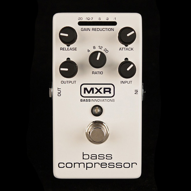

Not to be a broken record, buuuuuuuut:hybridpi wrote:...for those twinkly clean tapping parts I need high ratio, hard knee esque compression...
You can definitely get that in the MXR. And I have not noticed any tone coloration - again, don't let the "bass compressor" label turn you off. This is an anything compressor / limiter / whatever-er. And the "gain reduction" readout at the top (those are LEDs) makes it really easy to see what the pedal is doing to your signal, and how hard it's clamping down.

the MXR Bass Compressor is a 5 knob compressor with a gain reduction meter for less than $200. that many controls means you can do transparent or over-the-top in one box.
FYI that "compressor pedal" sound comes from a fast attack and a slow release. The MXR Dyna Comp for example has a 1 millisecond attack and a 1 second release.
