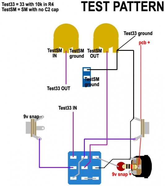

ps. how are you doing with rfurtkamps 'test pattern from hell'? http://media.furtkamp.com/gbtestpattern ... itches.jpg
i remember you saying you were planning to try it. have got as far as finding reliable vero layouts and schematics for the soda meiser and the 33 silver crank, and the test pattern offboard layout is here download/file.php?id=20972 so when i have caught up with my other building i will try to 'inflict' the rfurtkamp variations on that standard layout and post a final vero layout here. but may be a month or so, as am way behind with other things.

re test pattern from hell viewtopic.php?f=151&p=935608#p935608

I'm thinking the TP from Hell is out of my scope currently, so i'm planning to work up to it or have MSLP build it hopefully. (It'd be way prettier looking then) Thanks a ton for the schem for the FB loop/TB loop though! Once my new soldering iron gets in I think I'm going to start on that.
