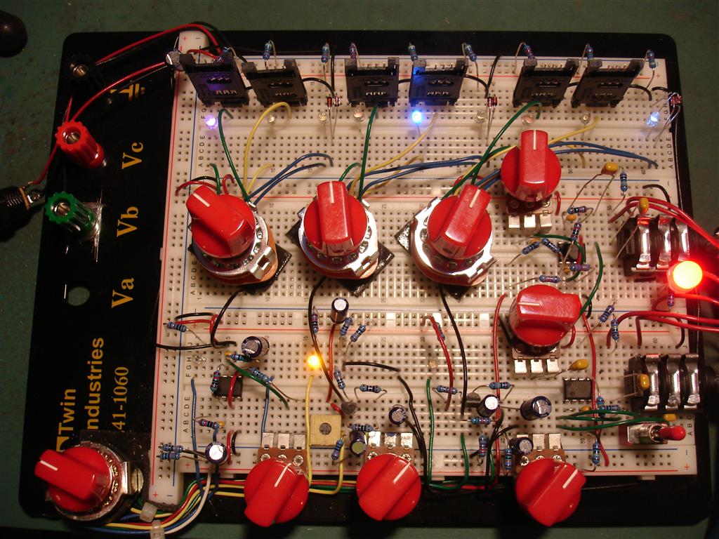

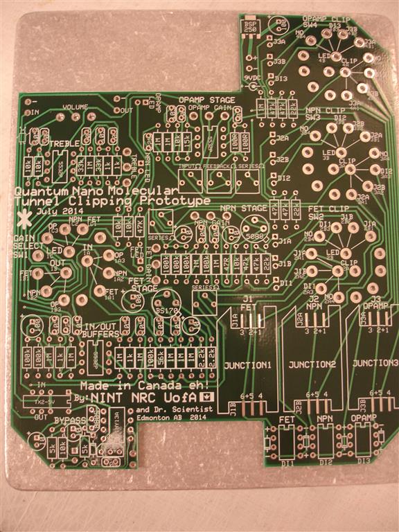

Ok, so they need a prototype! I spent a bit of time setting up a breadboard with some simple circuits that could show the molecular junctions off nicely. We bounced around some ideas and settled on this: This is the bread-board version of the final prototype, it's a circuit that shows off the molecular junctions through the most popular and common amplifying devices: a MOSFET, an NPN transistor, and an op amp. Each device is a single gain stage and they go from high to low, the FET is a dirty boost, the NPN is a medium gain fuzz, and the op amp is a high gain distortion. Each gain stage has a gain control and then there's an overall treble control and a master volume. It's buffered in and out so it's not as susceptible to external variations and performs consistently.
For each gain stage there's a rotary switch that selects between 2 junctions, silicon diodes, or no diodes, so the junctions can be quickly compared to other popular diodes or no diodes, all socketed for experimentation. There's LED lights for the gain stages and the clipping stages so one can look at the circuit quickly and tell how it's set.

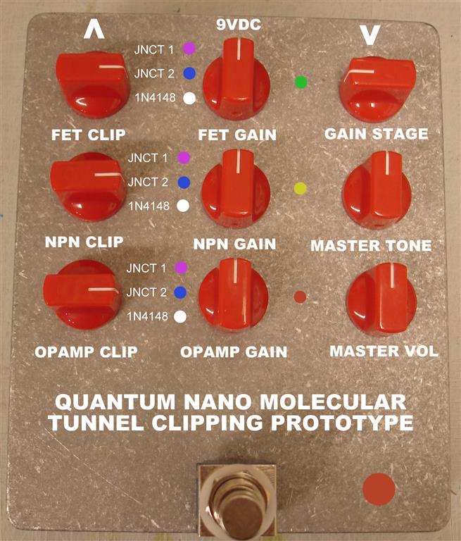

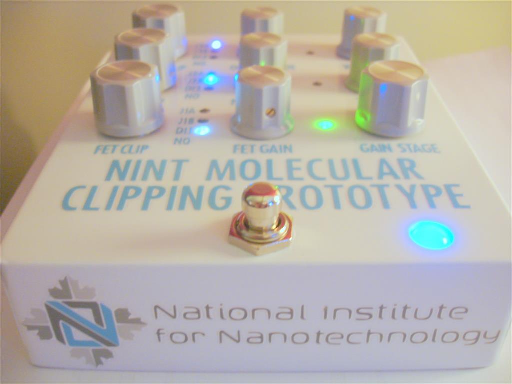

This is the mockup I proposed for the build: The NINT team liked the prototype circuit and commissioned us to make 4 of them. I designed a custom pcb for it that looks like this: And this is what it looks like built: See the big black SIM card holders at the bottom right of the pcb? That's where the molecular junctions are, there's 2 junctions on each SIM and 1 junction is like a back-to-back pair of regular diodes.

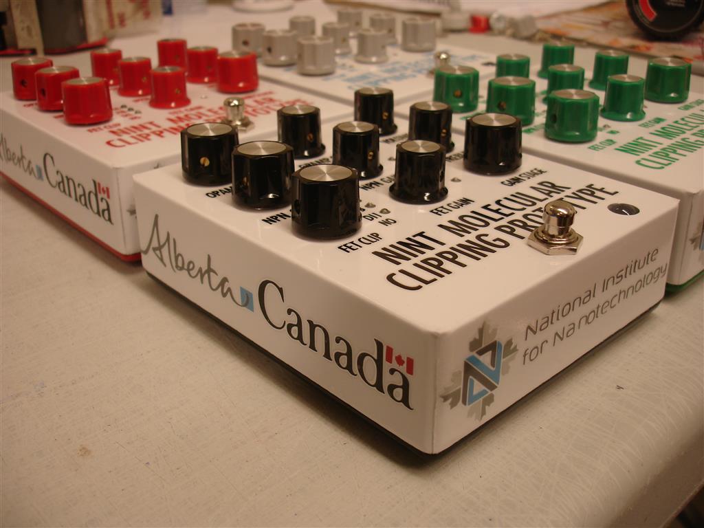

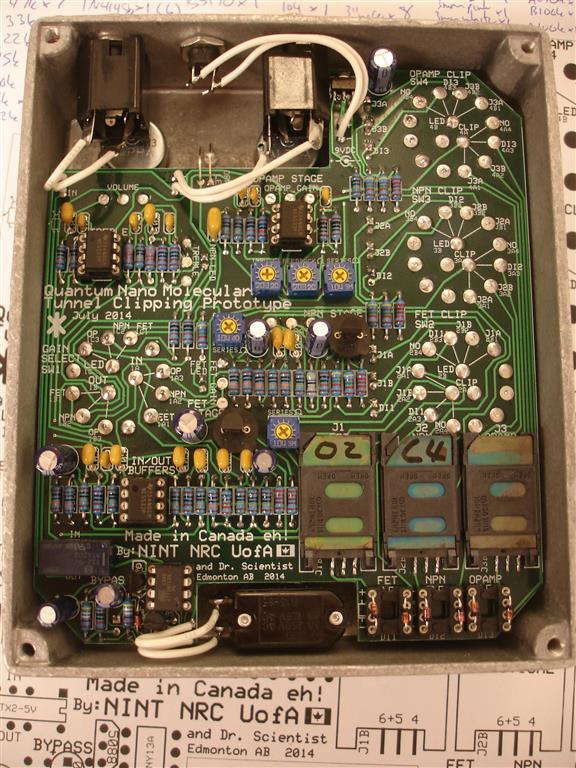

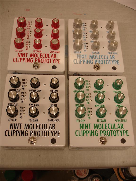

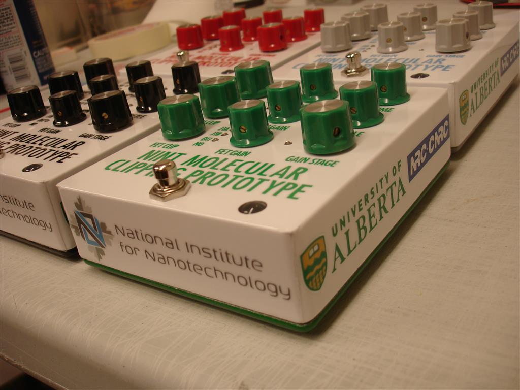

These are the finished builds: The finished protos had to have really accurate logos for all the organizations involved and this was Tanya's contribution to the project, this was a really tough job to do so small in vinyl: And here's one lit up: So the big question, how do they sound? Well, you guys know I'm not one for using a lot of terms like 'warm overdrive' or 'natural tube breakup' or 'transparent overdrive', I'm not really that guy.. but the molecular junctions have an unarguably noticeably different sound than typical diodes. First thing you'll notice is they keep the same level regardless of the saturation, they don't drop in volume. And then you'll notice that they really do sound natural and pleasant, smooth and warm, while also having an interesting character. They actually can make me use words like that! The 1N4148 diodes so commonly used in so many overdrives through the years sound very harsh, brittle, thin, and sizzley compared to the molecular junctions. I think the junctions have a unique quality to their sound too, they're really quite interesting.
What's so powerful about them as well is the fact that they can be tuned to emphasize or de-emphasize a number of characteristics depending on what materials are used for their conductive layer and substrate. Like they can be very mildly saturating or quite aggressive sounding. They can also sound different too by accenting or decreasing certain frequencies.

Is there a bit of difference between all the combinations of the selectors? Or is it a very subtle thing?

Thanks! Yep, there's a big difference in all the different settings.. all the gain stages sound very different and have different levels of gain/saturation, and then the junctions can sound very different. You can have one junction that's very saturated and one that's barely saturated, plus they sound quite different compared to the silicon diodes and compared to no diodes. That was the goal though, to show how different all the junctions can sound with the different gain stages and I think it's quite versatile sounding.Joe Gress wrote:Those are so fucking cool looking!
The proto isn't really intended to be a guitar pedal for sale though, it's more intended to demonstrate the nature of the junctions vs other diodes in the different amp topologies.. and it's all socketed so the NINT guys can swap in and out different gain devices and different junctions and diodes. Plus it's intended to be shipped around to other builders for them to experiment with as well.
I like that idea! But no, they're all separate and independent and you can only use one gain stage at a time. So you first choose if you want to use the FET, the transistor, or the op amp. Then you choose if you want junction A, junction B, silicon diodes, or no diodes. Then you adjust the treble and volume.John wrote:Fuckin' guy! So does each one run into the next? Can you turn each one off or??? I'm a little confused by the controls but I almost get it.
