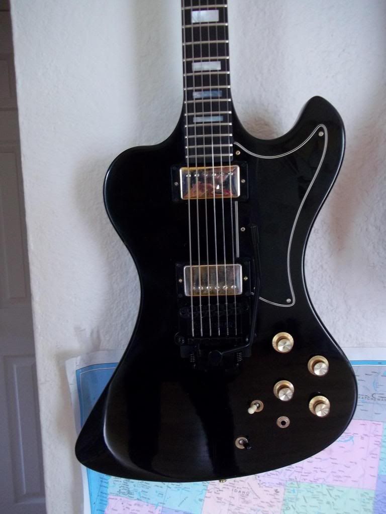

Yesterday, actually:
It's the Stetsbar for stop tail....
And i would have loved to love it...but...it won't work with my gauge preferance (11.56's) - the springs won't allow for much range - that said - it was more than i expected. The trouble is - i went to pull up - and the sucker POPPED on my and bar went up - i thought i broke it - and i pushed it back down - snapped back into place - but after that it had this funky play in the trem - nearly a 1/4" of movement with no change in the pitch - way annoying.
ah well....back it goes!

yah, cool concept. After taking it apart (to put the roller bearings back in) i feel it's not well built for the price.

another bummer on the stetsbar - you can't remove the saddle to change to graphtech, etc - they are bonded in at the nuts!

It's hard to believe that a jazzmaster trem could actually feel more substantial than another system....but it mine totally trumps this. Maybe i just need to route?

I like the idea of a bigsby, but i think my real love is the range that my jazzmaster trem has. Trouble is, RD body thickness won't allow....i think it's going to stay a hardtail w/ the TP-6.

Ok, so an update on this!
zzounds would not take the trem back. Period. over. end of story. fuck that place.
So, i called Eric Stets at Stetsbar....he's going to exchange it for another one and personally check it out to make sure its right. Furthermore, he's getting some saddles from Graphtech and installing them on my bridge for free.
Lets hope this all ends happy.
