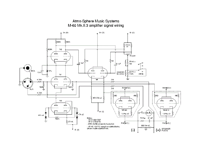

depends on the circuit.
here's the amp i'm talking about. it's a mono block, so this is one channel and its a fully balanced design. the power tubes v5-v8 are + and v9-v12 are - of signal i believe. or vice versa doesn't matter. also its an output transformerless design. its a 60 watt design, and uses 12 tubes. per monoblock. so it gets toasty in the summertime and i'll pull two power tubes from each +/- from both amps to run them at 30 watts. If one of the 4 driver tubes were to die....that's a different story. there's a cool video of the owner playing music through the amps, and he takes a piece of metal and shorts the outputs...nothing bad happens :) really great amps.
