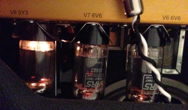

Depends how much and how hard you play it. A noticeable loss of output and/or gain could def be a sign that the power tubes are bad but very likely due to the switch from HBs to singles. How do the tubes look when they're running? What color? All uniform or does one look off from the rest?

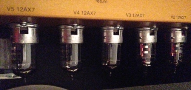

Here what I have in the amp right now:
V1 to V2: TAD 12AX7-C (The Sovtek have been replaced due to microphonic noise in 2009)
V3 to V5: Sovtek 12AX7LPS
V6 to V7: ARS 6V6GT (it’s written Tesla/JJ on one of them)
V8: ARS 5AR4/GZ34
The V6 6V6 look a bit paler compared to the V7.
Never really got any light on those Sovtek... thats normal.

Could be tubes. Could be the bias slipping/shifting.
Unless I'm completely wrong (feel free to correct me, anyone), 6v6s are a little like el84s in that you shouldn't expect too much life out of em, they just don't last forever.
A lot of new 12ax7s just don't "light up". Its all good.
Drop those sovteks and get some tung sols or EHXs though. You'll thank me later.

If you do end up needing new power tubes, best to swap the rectifier tube out at the same time.

Maybe I should replace those Sovtek-LPS for some TAD or some Tung-Sol to start.
