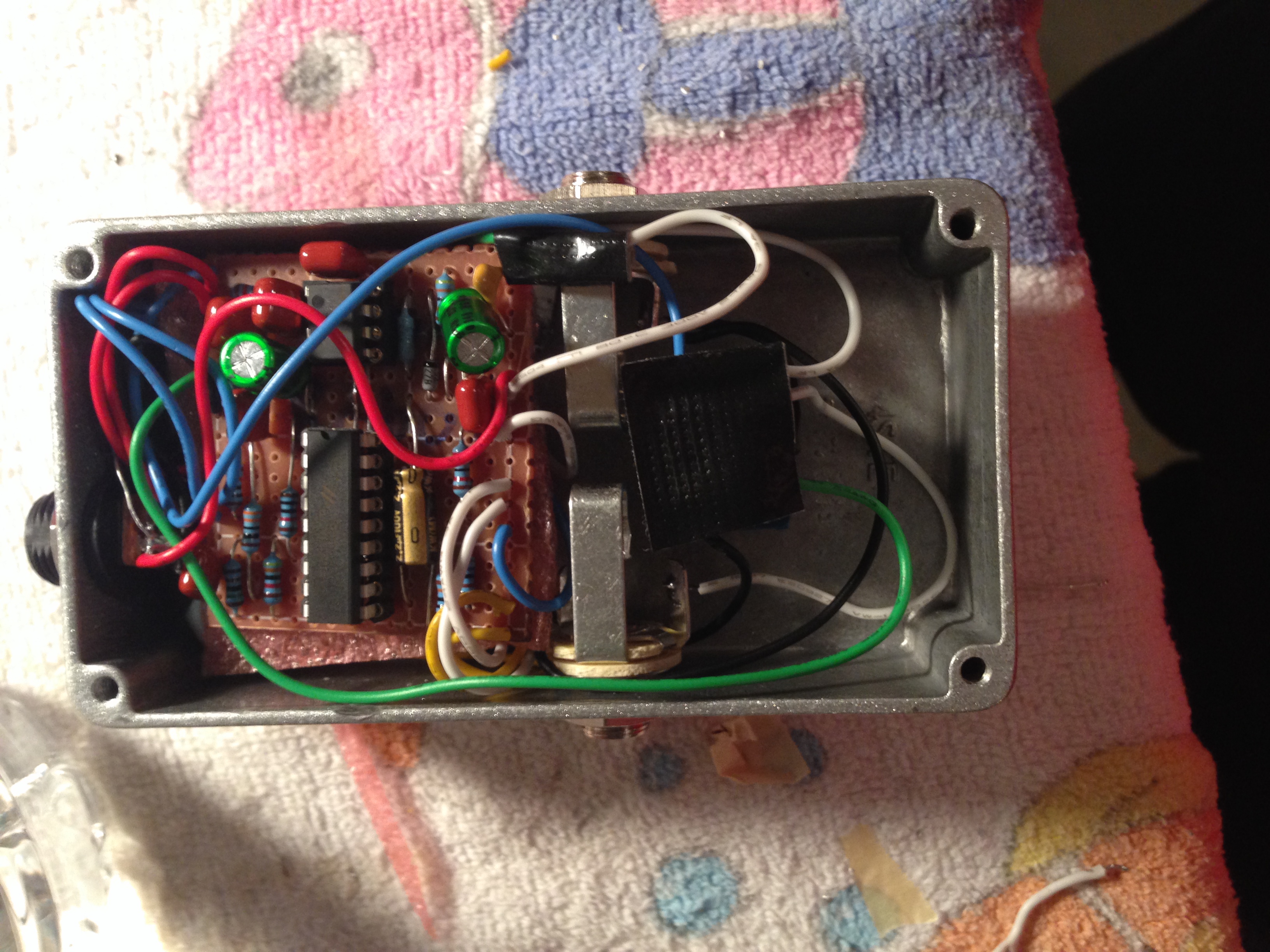

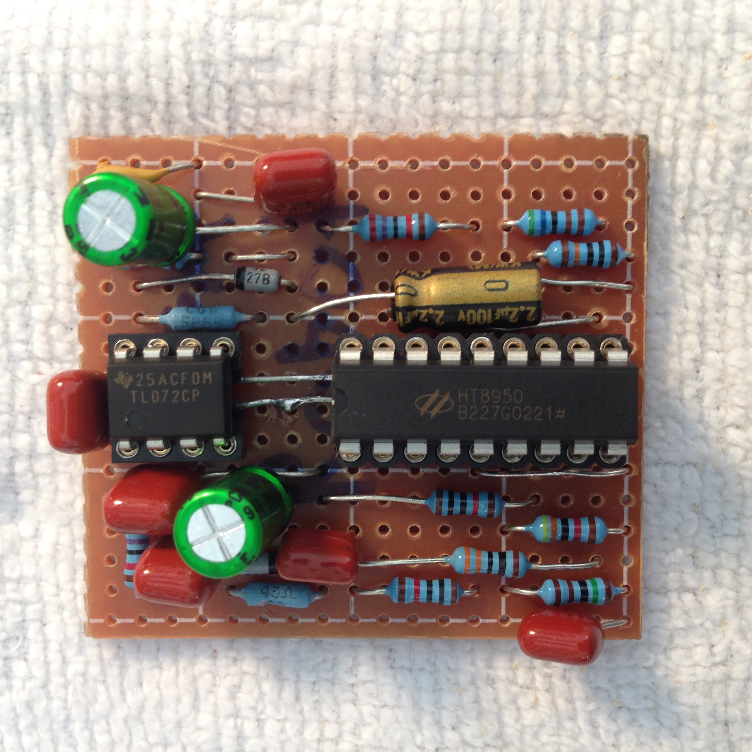

I'm having trouble with high pitch noise again. HELP? Could I possibly put a volume trimmer on the input of the circuit so that the volume is never max? Also, the switch pops when I press it. Please help, somebody, I'm kind of lost on this one.
Here's the board and everything.

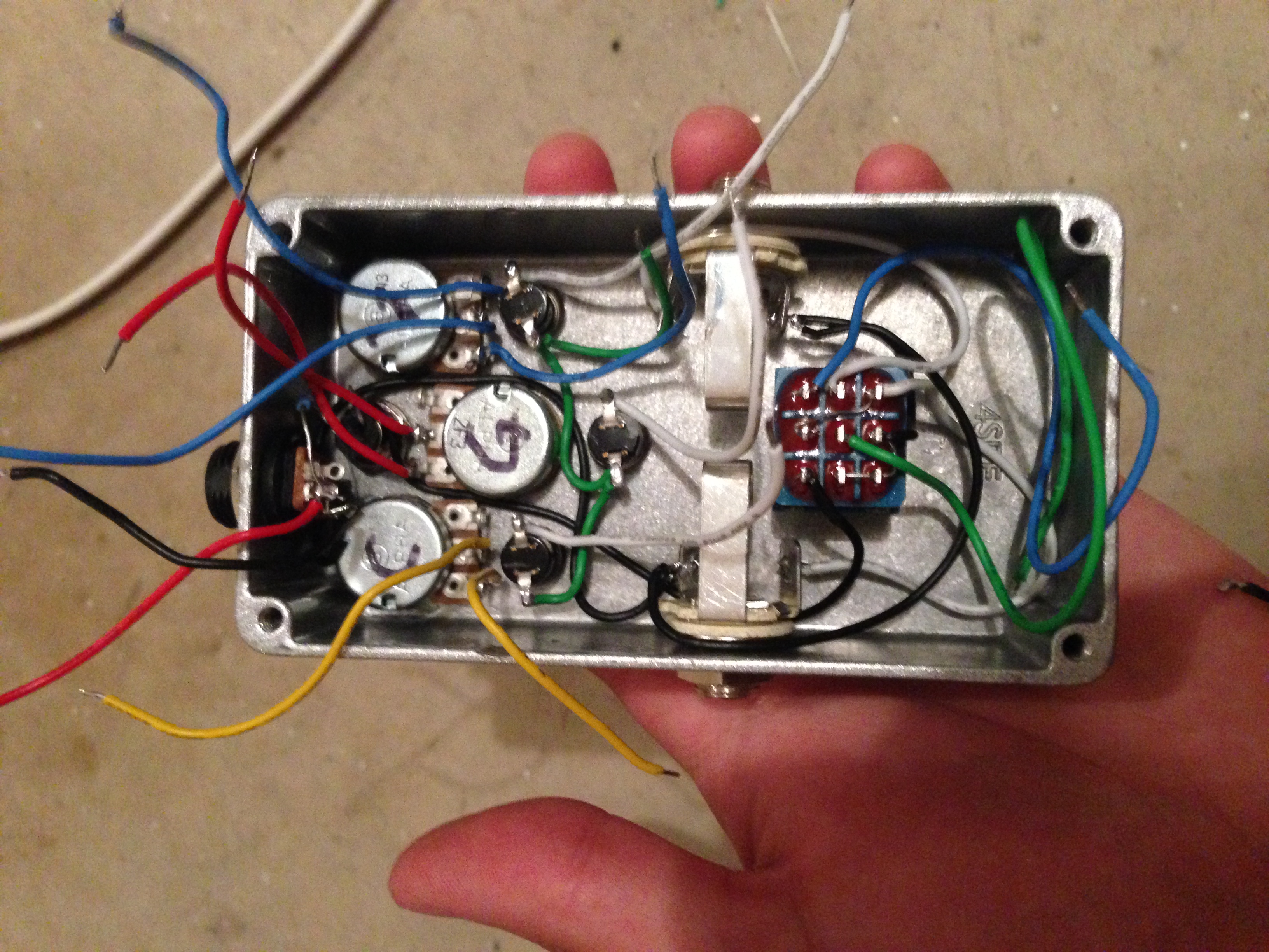

Also note that when I took the 2nd pic, I hadn't finished the off board wiring yet.
- eatyourguitar
- Posts: 3127
- Joined: Sun Oct 03, 2010 12:37 pm
- Location: USA, RI
Re: Death By Audio Robot
I think its your layout and long wires. if you had a 2-layer pcb with ground plane and pcb mounted pots your problem would be less likely. after all, it is a correct schematic right? check the tagboard effects blog and see if anyone actually tested this layout. check it against any info you find on FSB. they sometimes make mistakes at tagboardeffects

I don't think it's the layout. it's verified at tagboard. Im building the rotary switch version which works better. Idk, but I'm convinced it's a bad volume pot, because I've had this problem before with a fuzz, and it's volume pot.
