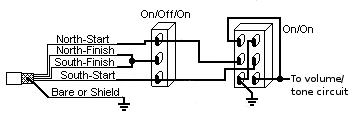

iWanna wire it so that it's the 3 humbuckers w/ coil tap and phase switches + a master kill switch, 1 volume, 3 tone controls

Tone controls aside, here's the coil tap/phase circuit. Repeat for each pickup:
- Attachments
- sammy.png (10.08 KiB) Viewed 2953 times

so ok, for sure the HB->coil->phase->volume set up is gold
so what if each pickup was going
HB->coil->phase->volume->tone bypass->tone->kill->master kill->jack
then each pickup would have it's individual switches/controls and not touch the others,save for the master kill........right?
