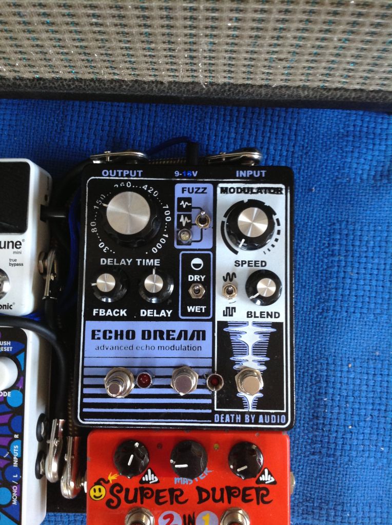

Modded my echo dream for tap tempo just to see if it could be done and it totally can!
I don't really use tap tempo but its cool that it can be done, used a taptation ic and can confirm that the dream is a pt2399 based delay. With the fuzz switch and the tap tempo I think the echo dream is a really cool delay pedal. Sounds awesome doing tap wet only modulation and then kicking in the fuzz all without using my hands

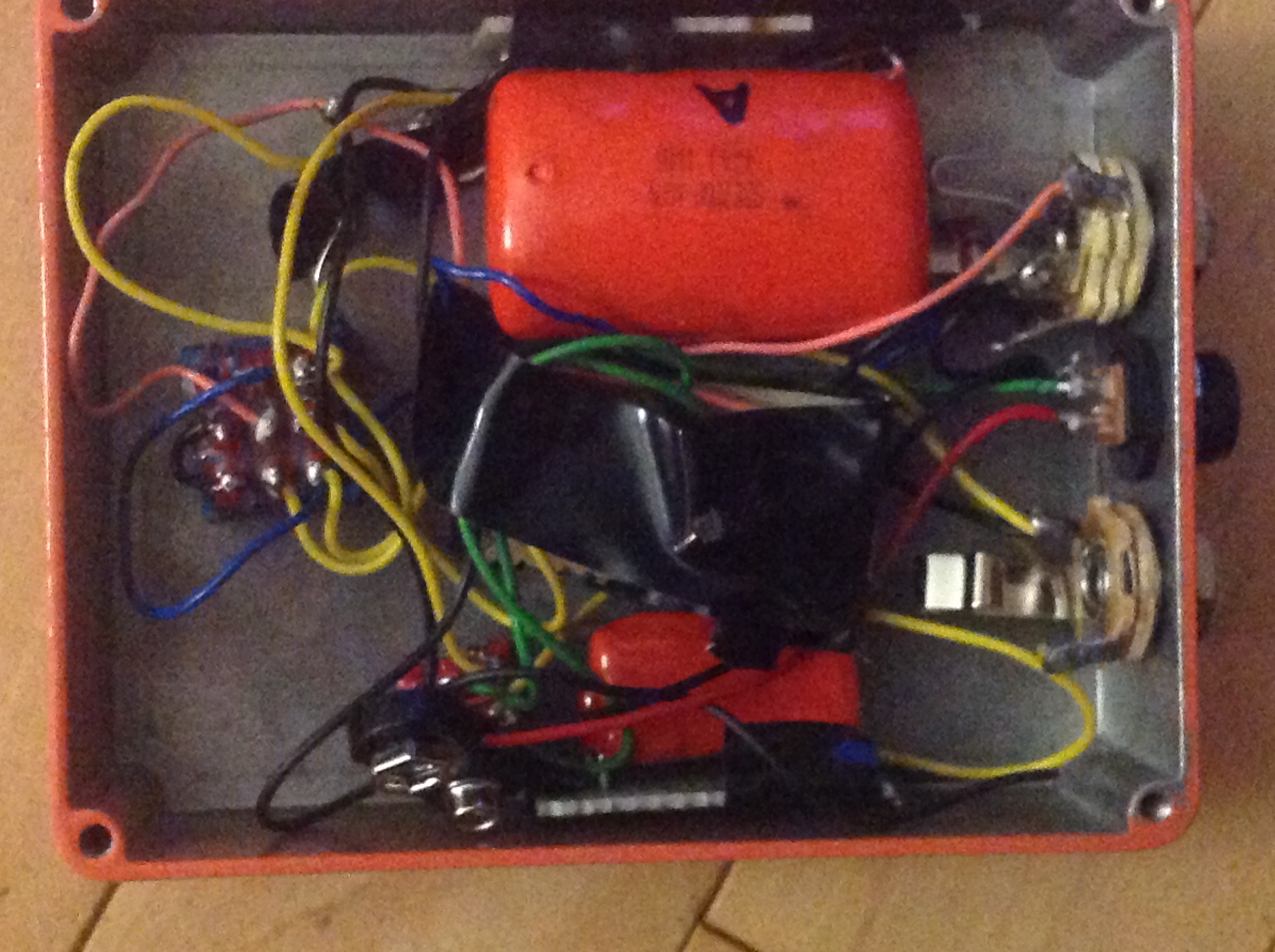

lapsteel wrote:Here's my first:
Meathead with dark switch, bc108, bc109, the biggest 470n cap ever (orange drop), totally messy guts but it is the meanest loudest fuzz....just nasty goodness....
I still think it is interesting to look at your big orange caps. it does not need to be pretty, it just needs to work. the reason I say guts, is that without guts this thread would be just like every other thread where we just stare at guitar pedals we know nothing of how they work or whats inside, who built it etc... you never know when someone will post something with a machine made SMD board. there are people in here that sell pedals and post in this thread but I draw the line where its made in china so therefor NOT DIY in that case.

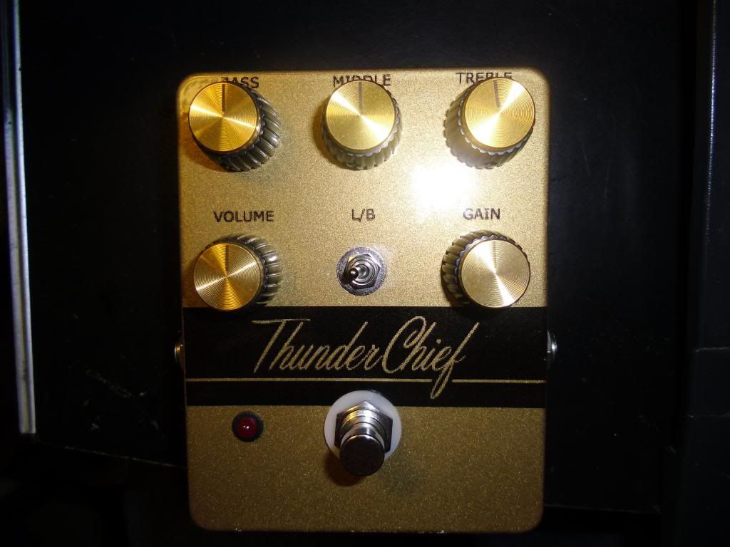

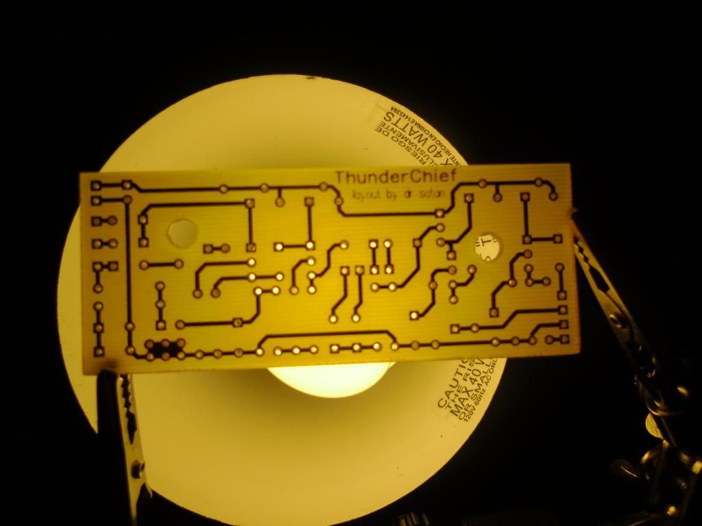

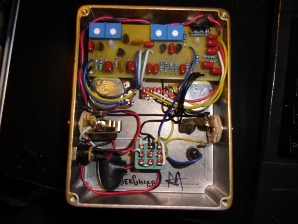

The ThunderChief from RunOffGroove with tone stack. Haven't really got deep into it, just some quick testing, but it seems like it does a pretty good job of copying a JTM. Pretty low~medium gain that cleans up with guitar volume. Stacks well with others. Behaves very much like you would expect a tube amp to. The L/B just switches between two different output caps, one gives you a little more bass than the other, not a huge difference but it does something, lol. Kind of like the tone switch on the TCE MojoMojo, it does something, but it's not terribly obvious. May go to an even larger output cap for more bass, right now it switches between the recommended .015uF and a .047uF. Might go up to a .1uF if I decide I don't like how it is.
