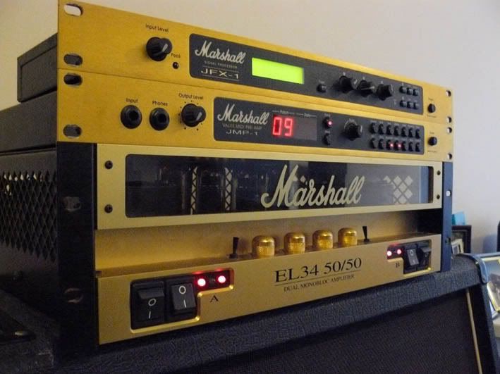

i used to run this...
and then i used to slave it from a framus Cobra ...two 4x12s and one 2x12...wet/dry/wet with stereo pingpong effects...
severe overkill...yes, pain in the arse to cart around/setup...yes...fun...hell yess
i also had teh 100/100 dual monoblock...i prefered the 50/50...there plenty of headroom for fuzzes/dirt boxes.

That one isn't the 50/50 I know about. When did that one come out?

Gone Fission I was talking about the power amp JohnnyC posted above, not the 9005. I believe they came out in the mid/late 90's.
