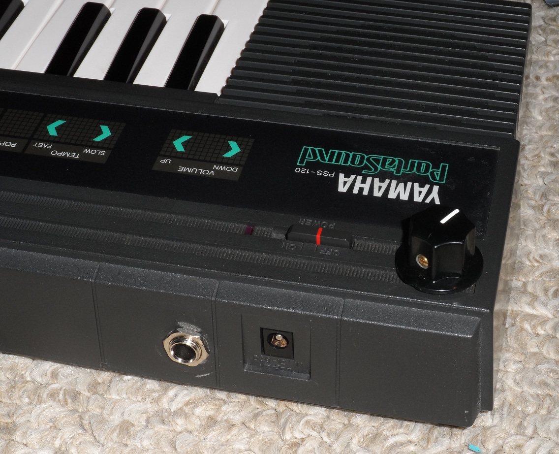

I picked up a cheap Yamaha PSS-120 32-key "synth" at a local 2nd hand store the other day. Perfect condition and cheesy as hell... I love it. The only jack on the thing is the 9v-12v power jack so I just added an output jack and a master volume pot. The speaker is still in there but currently not wired in.

Alright, so this is going to turn into my "help me do this" thread. I should rename this thread the "I'm not as big of an idiot as this thread will make me sound like I am... but I need help". There is nearly no literature online besides a basic manual (no schematics) online but it's ridiculously basic inside. So, first issue (also edited into the 1st post) I was having issues with running the output jack I installed with the speaker disconnected, played around with a few different options for awhile and ended up just running the speaker wires (amplified signal) directly to the jack. This works fine but the output signal is way too high. Rest of the details are in the 1st post.

Well, I decided to just run the speaker wires directly to the jack so there is currently no internal speaker but for the time being that should work. I also added a 10K pot to act as a volume as the straight signal from the speaker wires is pretty hot (from the amp) so the pot can help control that a bit until I pick up the necessary parts to do this the right way. Now, onto figuring out what effects circuits I want to build into this thing. :)
