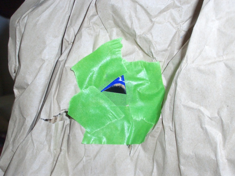

The lack of updates is basically down to me being lazy (Yeah, like masking is such hard work). Got round to it today though.(This is the tip of the longer horn BTW)

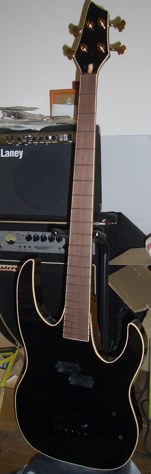

Last weekend I finished the clear coat and let it dry for a 4 days. This was followed by a couple of days of wet sanding the whole bass with 2000 grit sandpaper. Today I decided the surface was even enough (and I was in danger of sanding through the clear coat) and went on to apply the polish. This meant I could finally start bolting on the hardware I've had for almost a year!
(You can just about see the reflection of the tuning pegs here)
The fretboard also no longer needs any protection, so this is what the bass looks like right now (click for bigger):
Only a few more things to do! Apart from the soldering and mounting of hardware I still need to slot the nut.

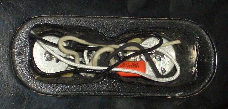

  • Forgot everything I ever new about soldering and cold soldered every single connection, which is probably the reason for the very loud hum at the moment.

The hum has also been fixed! The diagram I was using expected the controls to be mounted on a shielded pick-guard, thus connecting the two pot casings. Not having this left my tone control (I think) without a ground. All I needed to do was run a wire from the back of the volume to tone. My soldering remains shoddy though.
