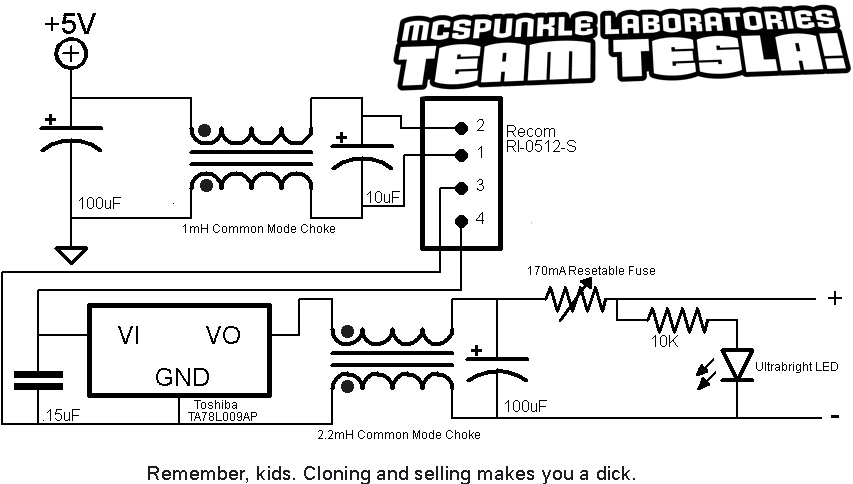

Team Tesla:
You repeat the whole circuit for each output (except the first 100uF cap). The cap values aren't critical, and you can get away with lower values, generally. The common mode choke at the output is absolutely essential, as the chips will interact otherwise. You can replace the input one with a normal LC filter if you want. The problem is, I was only able to find suitable CMCs in SMD. You can use a standard 7809 regulator if you can't find the Toshiba part (or an equivalent). It's a 150mA version of the 78L09. The first output should be grounded to the enclosure. The rest shouldn't.
In the near future, I'm doing a more efficient version using completely different parts. I'll post up the schematic, but it'll probably mostly SMD.
