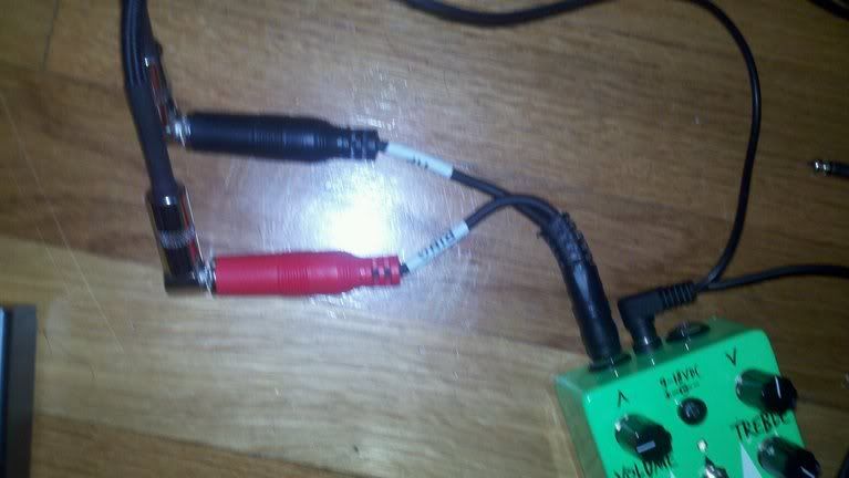

I use a y spliter so I can plug any length of chord into the tremolessence. got these near the dj stuff at guitar center. they should be pretty easy to find. even at radioshack. 1/4" stereo to two mono 1/4"

Awesome, didn't even think of using y splitters. Thanks a lot.

I use cables that are TRS on one end and then they split into two mono 1/4" ends. Got them on eBay for cheap but they work fine and I'm not much of a cable snob I guess. Like this: http://www.ebay.ca/itm/Hosa-Effects-Ins ... 20b0c834fe (I gotta learn how to do links here)

I got the same exact y-cable at guitar center. The question is, what happens when you have 2 or more pedals like that?

Then you can just use a normal TRS cable (with a TRS jack on each end), if I'm understanding you right, and the left signal will be on the tip and the right signal on the ring.
