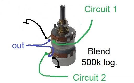

I use a stereo pot wired like this:

Wouldn't that mix the first signal out as it adds the second in? I want the first circuit to remain full signal and blend the second in series. That way, the main function/circuit is always there, and the blend would be no 2nd circuit fully ccw & viseversa.

that dual pot is good but I dont know if you want log. one of the resistive elements would need to be reverse log in that dual pot. you can a single 50k or 100k linear as a blend with the middle lug as the output. if you want it to only travel %0 to %50 you can just add a 100k to lug 1 or lug 3. the outside lug without the 100k resistor will always be louder or equal attenuation.
runoff groove has a schematic for the splitter blend that you can use as a starting point. you might not need the buffered splitter on the input. you might not need the buffers before the blend control. take what you need and leave the rest. it is TL072 based.

After the main circuit, you can use a typical blend circuit (like a B.Blender) to blend between just a buffer and the second circuit. Or you could do it with the dual pot idea (use the kind meant for guitar blend controls).
So, the circuit would look kinda like this:
Main Circuit > Splitter (parallel buffers) > Pot A > Buffer > Output
...............................................> Second circuit > Pot B > Buffer > Output
... I hope that kinda made sense.
