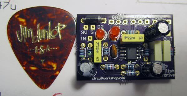

SHO clones are in hand. Man are they small!!! Fits in a 1590a in either orientation.
Here's the test build. If anybody wants it, I'll sell it on the cheap. Also, I'm putting together kits for the other prototype boards. It'll be a short run, but I can always order more. :)

Just got my tiny little "boutique 808" boards in. Man, these are small!!!

are they going to be on sale soon on your website??

fuzzmax wrote:are they going to be on sale soon on your website??
Perhaps. I still need to fully test the design to make sure everything is a-okay. But probably. Already have all the on-board parts ready to go.
