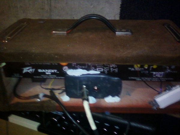

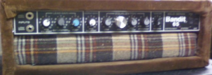

Any recommendations: Low wattage good tone max headroom?
Should I dig out my homemade peavey bandit head?

THATS AWESOME.
Chankgeez wrote:
- hbombgraphics
- Posts: 8654
- Location: Central NY
Re: Valve Junior Head Room
the best part is the light switch on the back to change channels and the speaker outputs made out of an old calculator back and some mighty putty.
It's an old jacket, still has a pocket on the one side.
More of a woodworking project than anything electronic.
