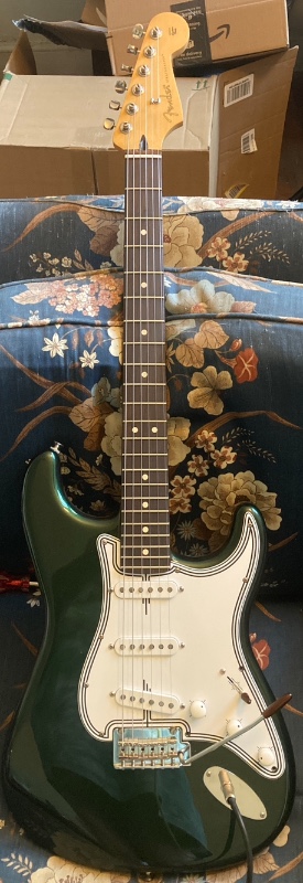

since my stuff was delivered yesterday, i got the replacement Strat knob and put it on today. i had to ream the aperture out with a 1/4” drill bit so it’d fit the 1/4” shaft on the Tonestyler pot, but the material is soft enough i could hand-ream it with the bit. i didn’t want to risk drilling through or breaking the knob with a rotary tool. it only took 15 minutes. a round of pickup and truss rod adjustments and it’s essentially done so glasses up, everyone! something’s finished.
mods included Fender CS ‘69 Strat pickups, nickel-plated flat jack plate, Stellartone Tonestyler tone switch, Decoboom “Streamline” pickguard and back plate, knobs and tips by Xentric Guitars of Colorado.

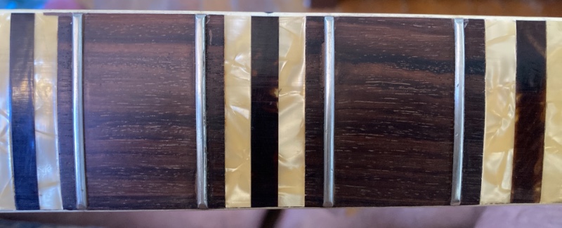

while waiting for Becky to be released from the hospital—she needs me to drive her home because she came in an ambulance—i’ve been sanding the parts of the fingerboard that were treated with grain filler but never sanded. four frets in it’s clear that i was wrong about it not working well on those areas…on frets 3 and 4 you can see quite a number of filled cracks, which show lighter on the dark background.
this makes finishing the neck simpler. i can just do the wood down to 2000 (my nicest is 1500 now) and it’ll be sorted, and then level the inlay stripes and knock down the wood on either side a bit. then if i knock out the back of the neck pocket and line it up i could mount the neck. i think i’ll do more polishing on that first.

almost finished sanding the wood parts of the Höfner fingerboard down to 1000 grit. it’s coming along nicely. i need to get finer sandpaper to finish that part and then file/sand the big inlay stripes to be smooth and knock down the wood along the fret edges that stands above the inlays and is in poor shape.

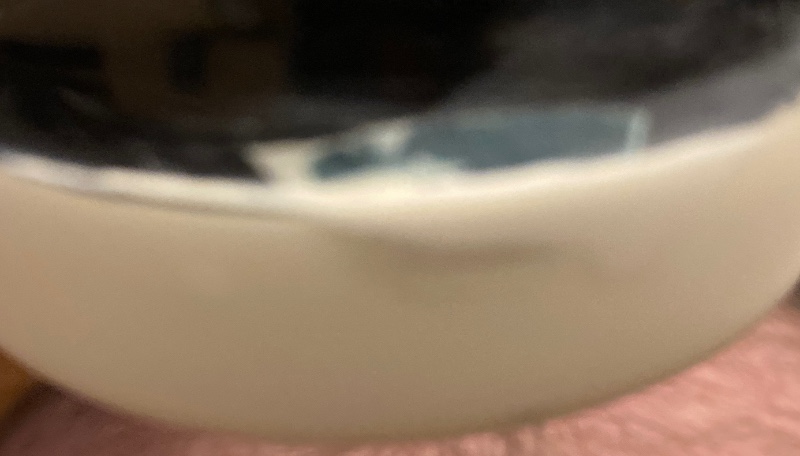

photos of the Jetstar work:
here you can see that the original crush dent is completely covered and smooth; you can see a bit of the original fill from the seller near the top on the right, the darker grey-brown. if the primer does its job the remaining stuff should be reasonably easy.
sorry the photo sucks. i tried several times. the color isn’t great, but the curves and planes are smooth. again, primer should help a lot.
i’m not dying to do another coat, and a lazier person would just cut to the neck repairs, but if there’s anything to learn from my saga it’s that little things count in the big picture. hopefully the next pass will be done and sufficiently dry to give me something to be thankful for on Thanksgiving.

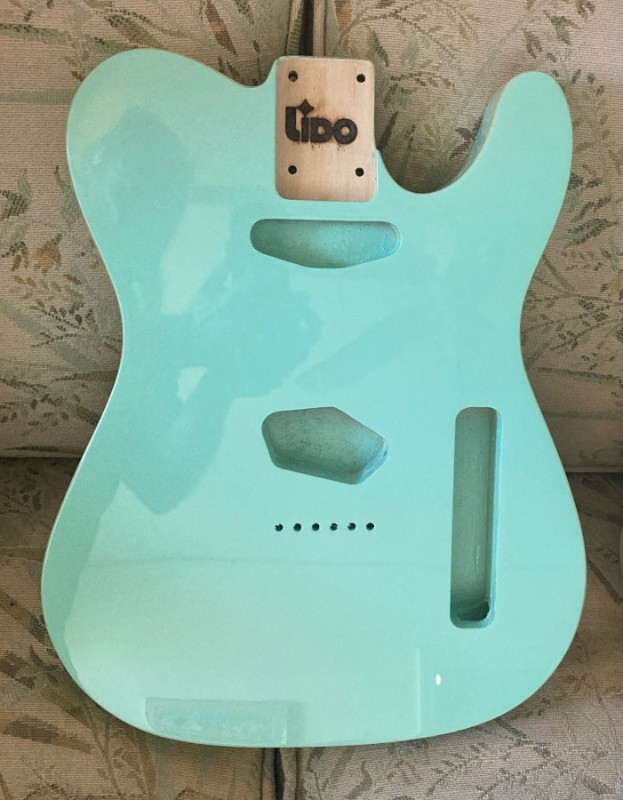

the GFS Lido import-spec Tele body arrived today. at first glance it seems nicer than the Jazzmaster body i got for the Galaxiemaster. i don’t see the kind of visible segmentation of multiple pieces here, or the same degree of orange-peeling. there are weirdnesses, though. GFS seems to have a real problem with color matching…the Fiesta Red JM body is more like coral, their Daphne Blue is rather more greenish than Fender spec, and their British Racing Green is more like forest green. the binding is also oddly variegated, yellower in some spots than others. i can live with it, but it’s peculiar. i think it’ll work. all the hardware and the Squier neck will get transplanted to here.

i decided to work on the Höfner fingerboard some more, and made a lot more progress than i expected. after trying to file down the wood bits on either side of the inlays on the remaining part of the neck with some success, i decided to try filing the entire area between those frets to get the inlays, which shrink at different rates and had uneven surfaces, flat and i’m quite pleased with how it came out. i went back and worked on the 12th fret some more and also got it flatter, with the added benefit of evening out the color a bit. i’ve gone over the inlay fret areas with 800 grit, and will take it down to 2000 tomorrow. when that’s done all that’s left to do with the neck is fill that small divot on the board at the first fret. it’s a bit annoying because i’ll have to clean the carefully moisturized wood with alcohol to get it ready for the CA.
