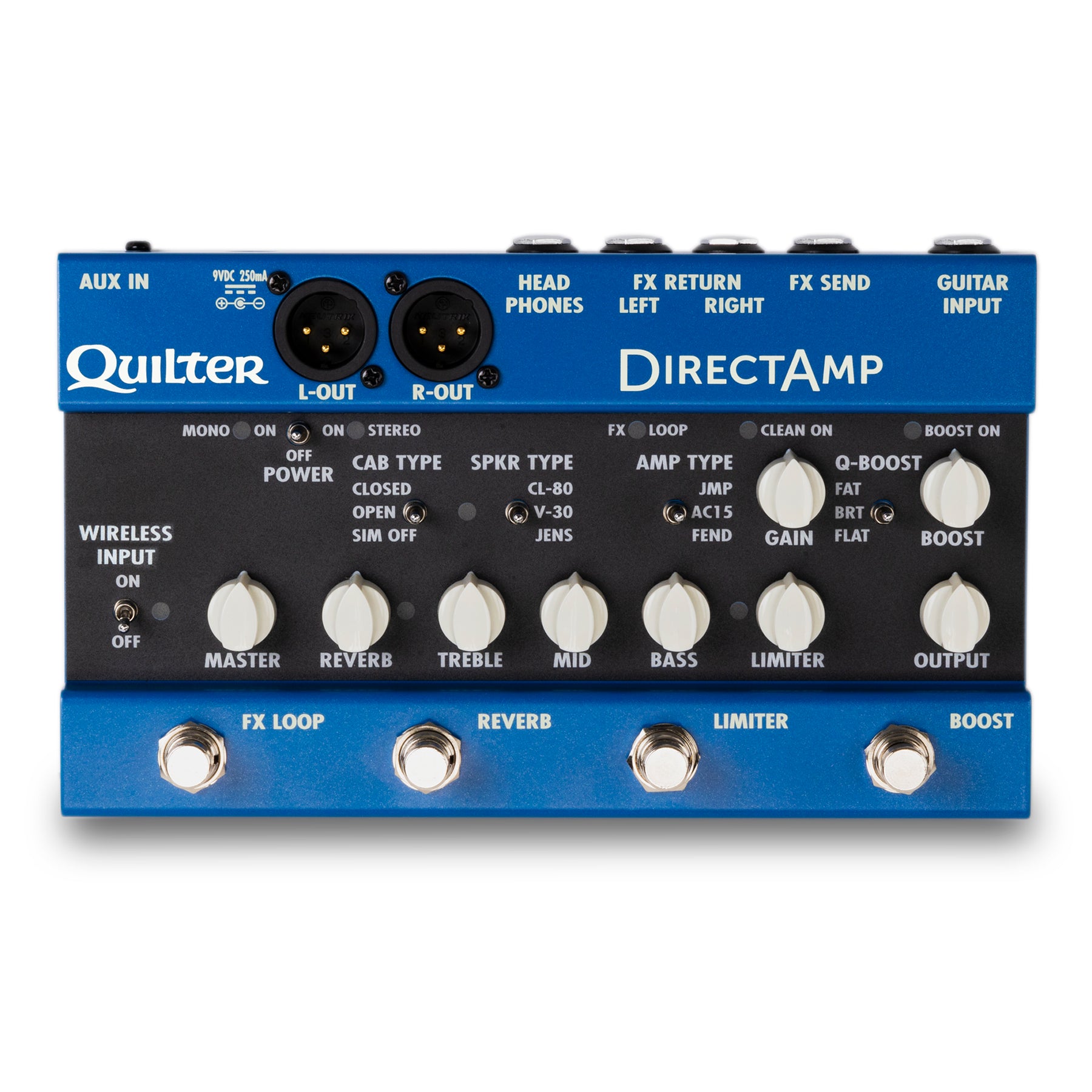

Not the cheapest solution, but Quilter makes a "Direct Amp" that has a lot of recording capabilities.
https://www.quilterlabs.com/collections ... /directamp
Quote:
Go wireless: Play along with tracks from your phone or tablet via wireless input. With an all new industry leading wireless input that accepts apple lossless, and APTX lossless codecs.
Three Legendary Voices: Craving that Marshall crunch, Vox chime, or Fender warmth? Flip the switch and dive into the iconic sounds of JMP, AC15, and FEND. Your tone, your rules!
Speaker and Cab Simulations: Mix and match Celestion Classic Lead 80, Celestion Vintage 30, and Jensen speakers with Closed Back, Open Back, or FRFR cabs. It’s like having a whole studio in your pedalboard!
Pedalboard-Perfection: Four footswitches for Gain, Limiter, Reverb, and Boost, plus a Mono FX Send and Stereo FX Return. This little beast plays nice with all your favorite pedals.
Stereo Awesomeness: Rock out with TRS Stereo Headphone Out and XLR Stereo Output. Whether you’re jamming at home or tearing up the stage, the DirectAmp has got you covered.
Compact and Mighty: At just 8.25" x 5" x 1.625" and 2.17 lbs, the DirectAmp is perfect for the gigging guitarist who needs a portable yet extensive solution.
Global ready 9-volt adapter No matter where your talent takes you, the DirectAmp adapter easily convert to various global AC plug configurations, ensuring you’re ready to rock no matter where you are in the world!
