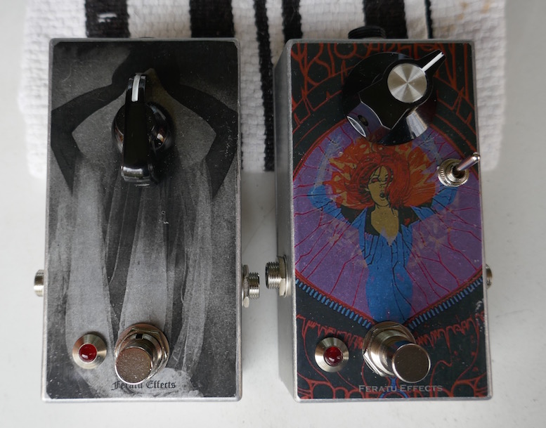

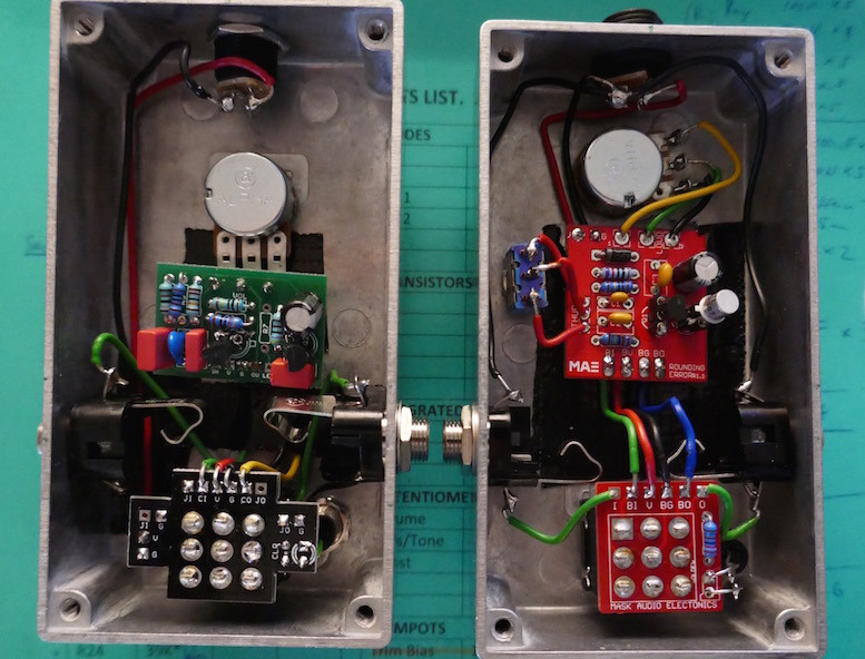

Boxed up 2 more, a Meathead (M-13) Dark on a Fuzzdog PCB and a Rounding Error on a MAE PCB that has been lying around for a while. The switch on that one is for different input caps.

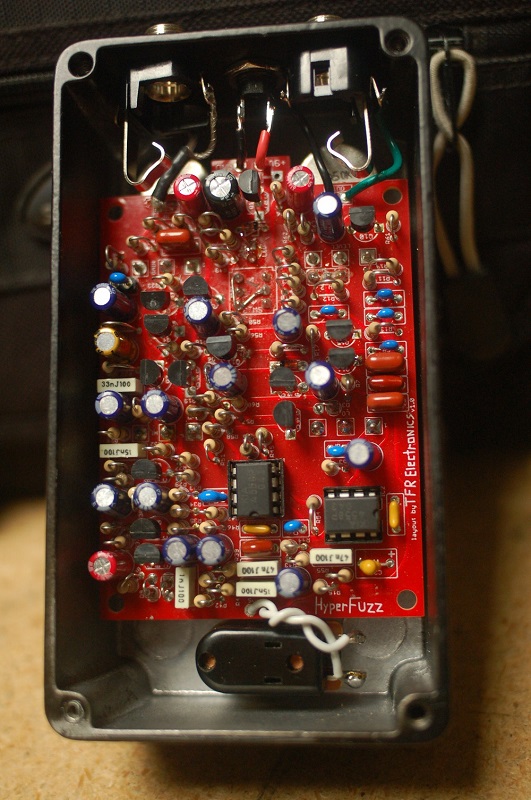

Here's a PedalPCB Parentheses Mini, kinda like a EQD Life Pedal V2 without the expression control.
I used 3 tantalums (C13-15) and matched D9Ks for the octave, as in the big one I made.
And because I can't handle two foot switches on a 125B, I opted for a wider encloure, resulting in more wiring.
So yeah, it's not super tidy in there ....

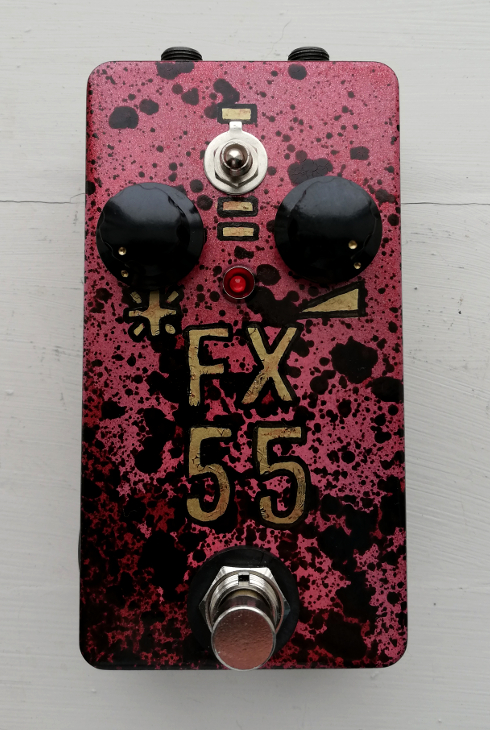

After a long, unproductive winter I managed to box up one of the 10 or so circuits I have lying around. A simple DOD FX55 clone with an additional germanium/BAT46 output clipping option for a more ragged and brighter sound.

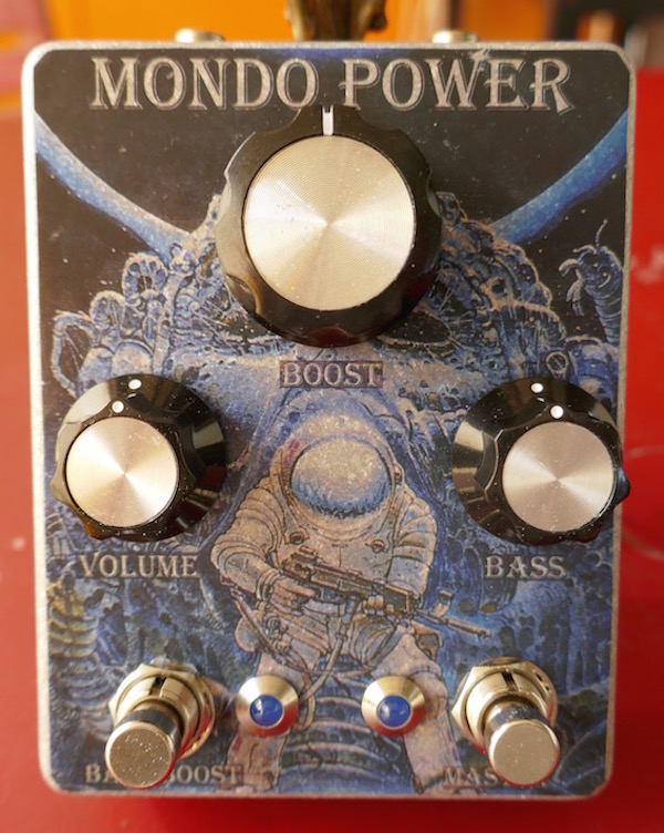

Here's something Dunwich designed: a Bass Boost/OD that doubles as an (power) amp. I've seen a few of them in the wild, but never got around to order one from the master himself before he hung up the soldering iron. Fortunately, Nick was kind enough to hook me up with a PCB, what a great guy!
The bass boost is killer and if used as an amp, it sounds surprisingly good with my old Italian 2x12" from the 70ies that I use at home.

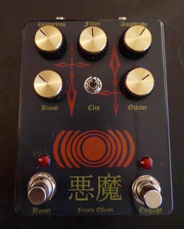

imJonWain
Posts: 1823
Location: AVl, NC
Post by imJonWain »
Nice! Awesome build. I need to make something like that

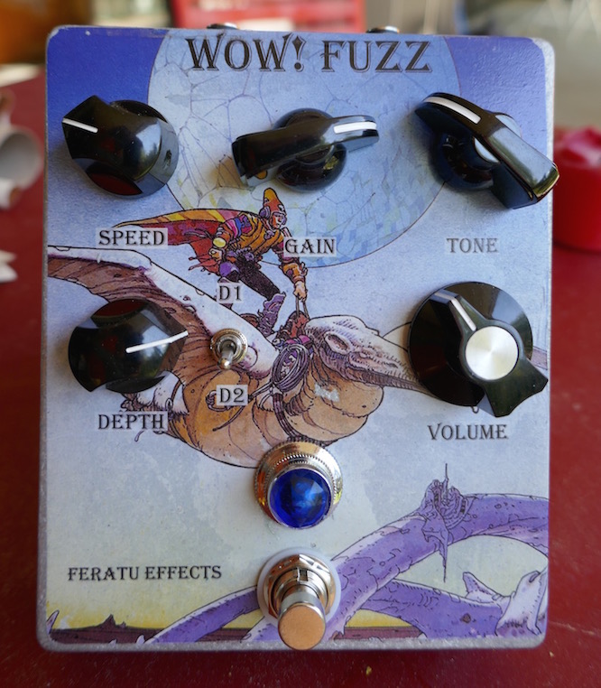

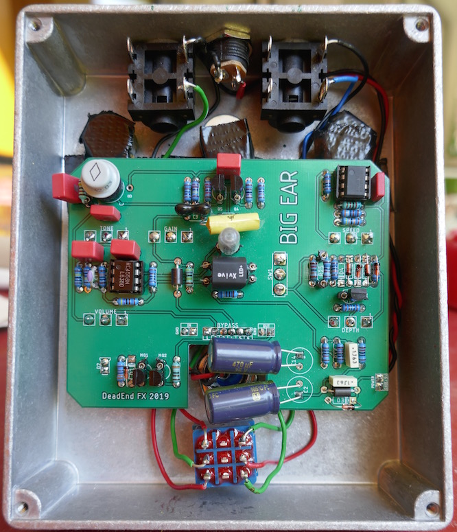

Here's my Big Ear, a Spaceman WOW Signal, PCB from the amazing guys at Deadend FX.
It's up and running, sounding great, but I still need to do some fine tuning.
Q4 and Q5 aren't matched, I just had one of each left and none of them is within the recommended hFe specs (one too low, the other too high). I ordered more of those to see, if I could get a smoother gain.
Then, I need to try other stuff in C8 and R25. Currently, there a 2n poly in C8 and the stock 16k in R25. Thing is, on the more extreme depth setting of the switch, I get a nice stutter effect, when turning up the Depth knob until the signal cuts out completely. That's cool, but it happens to soon on the dial, so that the last third of the turn does nothing. I'm not too sure about all this yet, but I'll see what happens ...
Q6 seems to be fine, I have 5.22v on E. (It's a MP14B though, as my P416As were a bit low on hFe, in the 30ies IIRC, might still swap that too).
Anyway, here it is.
