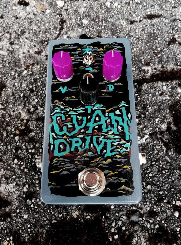

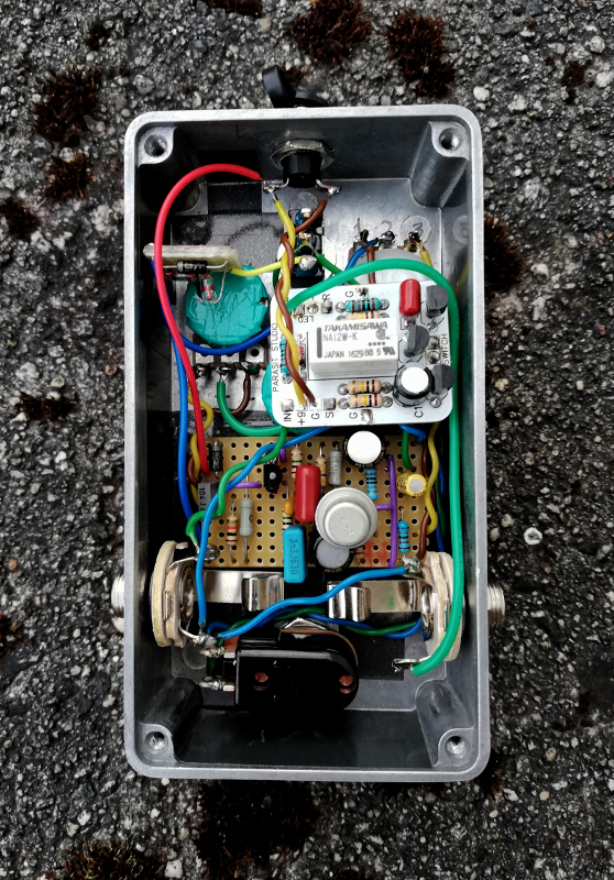

As usual I keep it simple but challenge myself a little space- and layout-wise. EQD Crimson Drive (it's out of production and I slept on an OG!) clone, but with Parasit Studio relay bypass and diode lift for cleaner drive/super loudness.
Using old, illegal paints made for a pungent vibrancy that's hard to photograph with a modern cell, and the knobs are more dark purple, but this is circa how it looks in grey outdoor light.
I really like this one, for devil music in particular. I tip my hat to you, Jamie Stillman.
[aaaaand I spotted the error - board input goes to drive 2 instead of 3. So that's why the gain kinda begins at medium.. :lol: I'll fix it later. That's what happens when u stay up all 24hrs to finish a pedal I guess]
