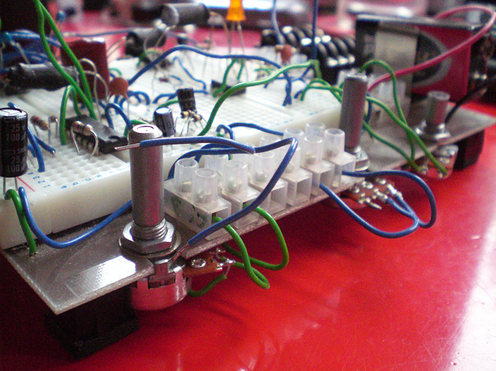

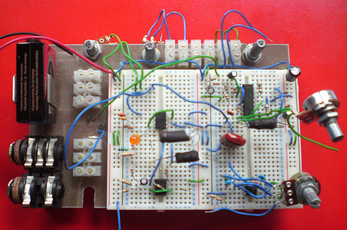

Not bad considering it was my first try at something using only a schem (no hand holding put X piece in y slot diagrams)
Everything is kinda bunched togeher so experimenting is a bit hard...I could have spaced it more and used a few jumpers but I figured that would make visualizing it much harder.
A few things I noticed: Volume. Not a lot of it. cranking the vol pot brings me around unity, and much of the range of the knob is somewhere near unity.
Great if you want exact control and don't need a boost , but devi's usually go from off > unity at 9 > ears bleeding at 10-5 so this was weird.
Also it seems very gated at lower intensity, almost like a gz. Maybe my memory is fuzzy but I don't remember the TP being that way.
...and it seems to like being starved. In order to even reach unity I have to use the starve on the beavis around 11oclock. There is a bit less volume when it gets a full 9v.
It's hard to check everything since I went for a clusterfuck layout, I might just redo the whole thing taking up as much space as possible to give me room to tweak/check everything.
