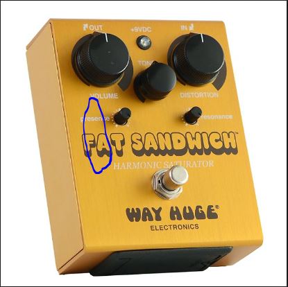

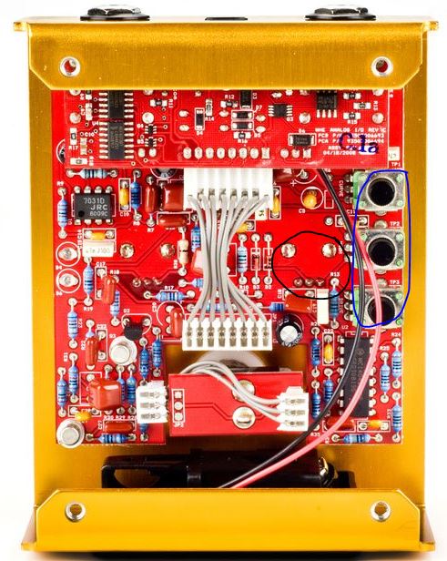

Looking at the front, you might be able to flip them to the other side and just drill out holes for them in the area that I've circled.
You can see how close the Presence (outlined in black on the PCB side) is to the other pots, so it'll be very close, but it's doable if you're patient and diligent.
You might have to change to different taper pots, though, since the rotation will be flipped.

jrfox92 wrote:Looking at the front, you might be able to flip them to the other side and just drill out holes for them in the area that I've circled.
That's actually exactly where I've been thinking of putting them :)
jrfox92 wrote:You can see how close the Presence (outlined in black on the PCB side) is to the other pots, so it'll be very close, but it's doable if you're patient and diligent.
jrfox92 wrote:You might have to change to different taper pots, though, since the rotation will be flipped.
I'll be getting different pots for sure.
