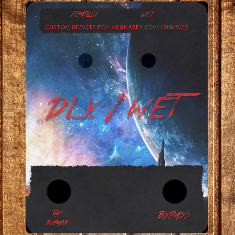

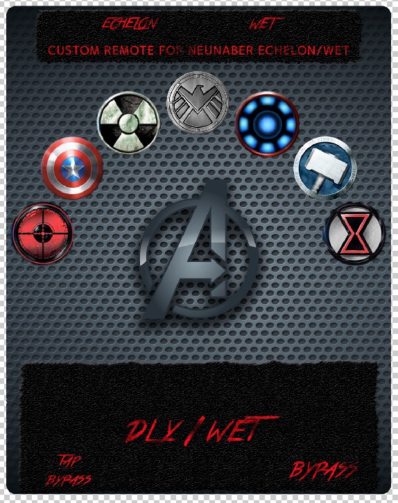

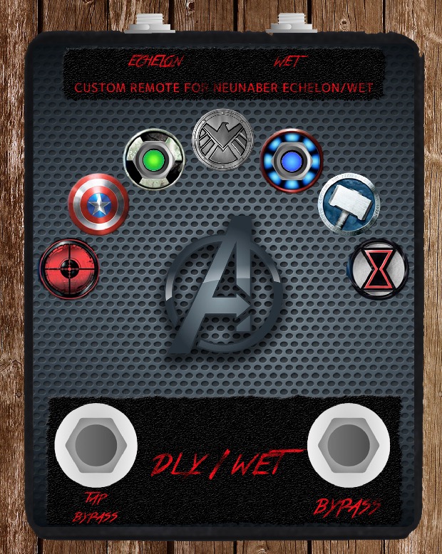

Was playing around with photoshop a bit and decided on a different design, with a green LED for the Hulk logo and a blue one for the Iron Man one.
Just waiting on parts now!

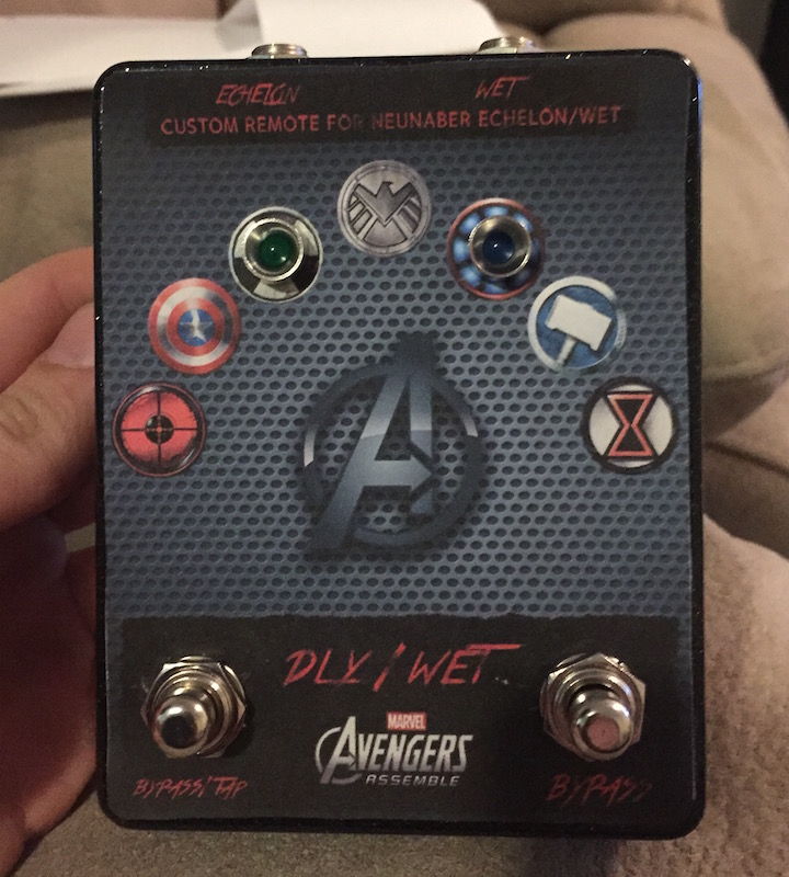

So got the parts and just did a quick print of my design to check how everything fits! Few minor tweaks but looking good!
Just need to wire the sucker, and put a transfer on the pedal!
