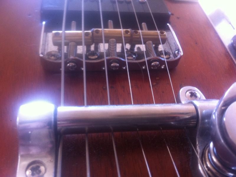

I use a cutdown ashtray on my bigsby'd tele. Works well for my needs, though I did put some magical anti rattle goo between the saddles because I was getting a bit of unwanted noise. No tuning issues or string breakage issues and it maintains most of the tele snap to my ears. However, my tele is a mahogany thinline with a p90 in the bridge and a firebird mini humbucker in the neck, so it isn't exactly standard. I tried a bunch of different bridges (Jazzmaster style, tuneomatic, bigsby bow tie bridge, wooden bridges with various saddles, etc) and always end up coming back to the three saddle ashtray.
I would love to try one of the Mastery tele bridges, though.
