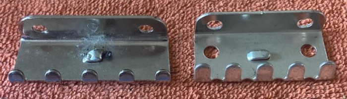

the Galaxiemaster spring chamber is a little trickier to implement than i thought, but still quite doable. counterintuitively the rout is wider than it is long, so i’ll need to run the springs at 90° to the string path rather than parallel. the second claw i ordered (on right in the photo) is a Squier-sized item and is much better for this application…it has holes so i can mount it perpendicular to the walls and gain more spring room, and also has longer tabs i can bend to hold the springs better. i ordered another and the chamber can wait until then.
the stock size of Fender tremolo springs is approximately the same length as the width of the rout, so i’ll definitely need to shorten them by a half-inch or so in order to have room to tension them with the claws. it’s yet to be determined how taut they should be; i imagine i’ll literally be tuning them to where they feel right and have a bit of BOING when the body is struck. it would be nice to see the actual chamber on the Vintage Revo Vision guitars so i had something to go on, but what’s DIY without trial and error?

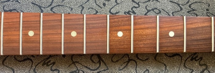

while waiting on parts and getting it together with the soldering station i came up with a couple of side quests. my MIM fretless Fender Jazz Bass needs a neck shim as a last-ditch attempt to avoid having the neck, whose truss rod is maxed, steamed, and the Lead II’s pau ferro fingerboard, which has a weird grainy texture, needs to be sanded. the board feel keeps me from really enjoying the guitar. i expect i’ll eventually have to send the bass neck out, but i don’t need that expense.

i got a third of the way through sanding the Lead II’s pau ferro fingerboard, and the difference is remarkable. it was originally surprisingly rough, and took a ton of oiling to be barely acceptable. once sanded it’s nice and smooth, and since it seems considerably harder than rosewood it should stay that way. what’s really surprising is how the color changes…the unsanded areas on the left are dull and predominantly reddish in hue, while the finished parts are browner. the light streaks become lighter, and the dark streaks darker. the result is a striking pattern that reminds me of a mountain sunset.
ain’t that purdy?
ain’t that purdy?
i would love to finish this today, but realistically it’s going to take until tomorrow because i’m not going to spend another six hours at it today. i’m really excited to play it when it’s done.

parenthetically, Fender seems to have problems preparing non-rosewood fretboards in their non-US facilities. this isn’t the only example; you’ll recall that i had to sand the Indian laurel board on the Esquire, which was made in Indonesia while the Lead II is from Mexico. it seems to me that they try to simply do the same processes as with rosewood, but that’s not suited to either wood…laurel needs to be grain-filled and aggressively polished, while pau ferro, being harder than either, comes to life when sanded to 2000 and polished. it’s unfortunate that the market life of the reissued Lead series was probably negatively affected by the pau ferro issues. i know other people online who also bought them sight unseen were similarly bothered, and i have to assume people trying them in person would have been put off.
