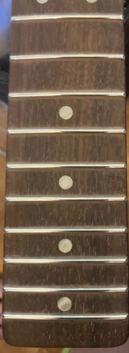

it’s early and i don’t feel like doing much, but i scraped the grain filler off the Esquire fingerboard and it looks to have helped, particularly on the upper frets. with some sanding to level it out it should be nice.
the lighter streaks are the filler.

i sanded the first 2 frets with 1000->1500 grit and am quite pleased with the results. i don’t really see the point in polishing fretboards any finer than that because they’re going to have strings scraping across them. here again you can see the filler on frets 3 and 4, and how it disappears into the background once it’s oiled.

on reflection, i decided that laurel really needs to be polished down to 2000 grit to look good…it was still a bit dull compared to rosewood, and the extra work made it much better.
i also managed to install the string ferrules in the back without any obvious fuckups. they did not precisely fit the body regardless of claims by GFS, so i had to ream the apertures with a hand-held drill bit. using a powered drill would generate too much torque and take paint off in chips. that wasn’t too much trouble, but unfortunately the lips around the outside of the ferrules doesn’t fit the countersink either, and i’m not getting into hammering them in. so they stick out.
i also finished the fingerboard, whose figuring is nicer somehow than the usual variations in other woods that irk me so. the lighter parts are slightly translucent, which makes it light up in bright lighting.

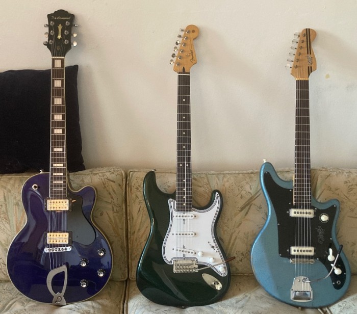

spent some time today optimizing some of the recent projects that are pretty well finished, those being the Hopf, the green Strat, and the M-77 with the Gold Tone humbuckers which i actually started on yesterday. turns out that for them to sound good, the Gold Tones need to be cranked pretty far up towards the strings which brings out their full loudness--they're supposed to be like 11k--and thus makes the guitar rather louder than most of my guitars. the Strat and Hopf are low-output in comparison. it'll need to be rolled off with one or another of the clean boosts when run into the boards if i’m matching levels for looping, or i'll have to adjust the amp if i'm playing live. the GTs have a certain je ne sais quoi about them, and subjectively seem to have more upper mids than a typical 'bucker. i still need to work it out to see what works best for it. the Strat is great other than that it's a bit buzzy and could probably use a fret dressing, and the Hopf continues to delight with its newly snappy tone and improved resonance. you didn’t really think i was going to miss a chance to post a photo, did you?
deep greens and blues are the colors i choose.
i ordered some odd pickguard screws. there’s a batch made for beveled holes that sits flush to the guard that i’ll use for the Galaxiemaster, and some standard sized ones with slotted heads rather than Philips. at first i thought i’d put them on one on the Tele-oids, but on consideration i think they belong on the Hopf, whose pickup adjustment screws are slotheads. they’re out for delivery today. i still need some plain vanilla screws for other projects, but they can wait.
