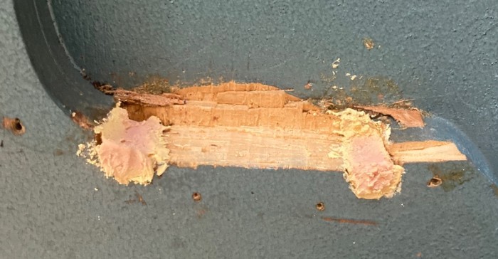

i got into the Hopf today and it turned out to not be too bad. the StewMac chisels did great at pushing back the edge of the rout so the bridge pickup clearance is sufficient. i mixed up some of the rosewood grain filler and taped off the open side of the bridge stud holes and packed them full of filler slightly above the level of the top since it’ll shrink when it dries. once it’s settled i’ll level it off and paint it black so it blends in with the pickguard.

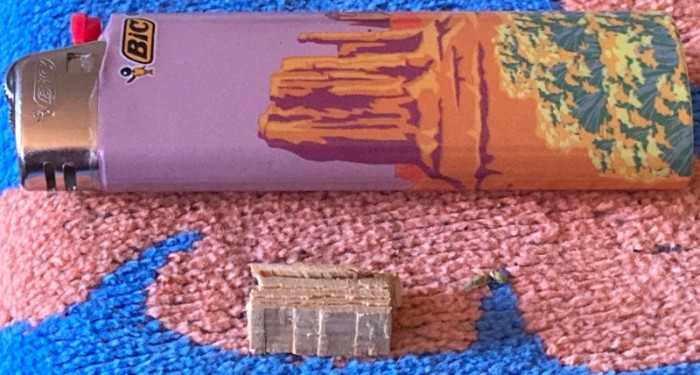

a side note: i’ve long been curious about just what material the Hopf body was made of, and while chiseling out the rout pieces came off and then broke into smaller pieces in symmetrical layers indicating that it’s some kind of laminate in layers about 2 mm thick. i’ve seen claims on the internet that it’s the same material as the neck and is probably pine or linden. i can’t confirm or deny this, but the neck resembles the Framus laminate necks which i believe were maple. it also seems unlikely that a pine neck would work with the neck’s tiny truss rod and adjuster. at any rate, it seems like plywood was the postwar German material of choice.
