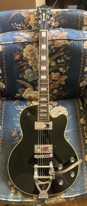

it took a little doing, but i got the pickups in. i used one of the narrower chisels from StewMac to take wood off the sides of the cavities so the tabs the adjustment screws go into would fit. when i started setting up the pickups before installation the screws from the parts box started slipping when adjusting the height; fortunately i found a small ziplok in the box that had held the M-77T parts which had the correct screws which are a finer thread, but they needed the ends ground off like the other screws because they were too long to fit. i haven't screwed down the neck pickup because the wires from the bridge pickup are too short to reach the switch cavity. given that the pickups spec as neck = 8.0kΩ bridge = 8.2kΩ i'm going to just swap the positions rather than muck around adding length to the bridge pickup wires. when that's done i'll need to wire up the regular Gibson-style toggle switch from the parts box...i have an actual wiring diagram for the M-75T with the correct color codes for the wiring so it'll be especially hard to fuck up.
these should be good...i Googled around a bit to find the impedance and saw photos someone took of the innards of their FB720 pickup and they're constructed like real Firebird pickups, not mini-hums in a closed shell. i played an Epiphone Uptown Kat with these pickups and liked it enough that it was on my shortlist before this project came up. it was absolutely great for Neil Young stuff.

i got the pickups installed per my last post with the neck and bridge pickups swapped. i had to take out the bridge pickup again because it needed different springs on the height adjustment screws so i can crank that pickup up to where the housing is almost coming out of the ring, which i may need to balance the pickups. if it's not high enough i'll order a Dynasonic shim to lift it a bit more. i restrung it and it's currently quite playable, though i need to do a proper setup once everything's wired up. i really ought to do the switch today...we'll see how my energy level is doing later on. i must say it looks badass with the Firebird pickups and Digsby. now that the pickups are in i can measure how much deeper i need the pickup cutouts on the pickguard to be; i'll have it made so the cutouts are as deep as the pickup rings so i can get it close to the surface on the upper end. this may wind up being my most dangerous project guitar. Firebird pickups, mahogany (well, nato...i always wondered what Warsaw Pact wood would look like before i got the Musima), shorter scale than an actual Firebird, and the Digsby. it should have serious teeth.

yes, the neck pickup is slightly crooked in the photo. i corrected it. that's what happens when you're using screw holes in a pattern slightly smaller than the screw holes in the rings.
