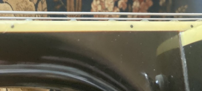

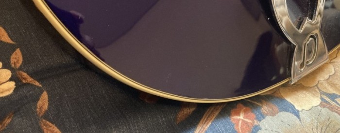

i did try some clear CA--i had some Gorilla CA in my tools boxes--to fill the scratch. it didn't work particularly well, but that kind of deep scratch on a curved surface is really hard to fill effectively. it is much less obvious, though, so i guess i'll take that. it doesn't jump out at you, whereas it was very visible in the seller's photos. the poly clearcoat worked much better when it came to getting rid of the scratches on the neck. still not invisible, but you can't feel them any more. i have one more possible thing on the M-75. there's a chip out of the finish on one side of the headstock that seems tailor-made for a drop fill with black CA. but do i care enough to bother? anyway, i reckon the next thing is the Jetstar fixes. i really wish i could contract this kind of shit out, but i can barely afford the guitars in the first place.
anyway, that makes the M-75 done except that one ding, the new pickguard, and perhaps a little more polishing on the areas i sanded. i'm calling this a successful project: got the guitar for less than half of what they usually sell for, minimal added investment in parts (knobs + pickguard, less than $100 in all), and not much repair work. it took me longer to figure out the pickups than to fix body problems. and i got lucky by getting a 25-year-old guitar with a straight neck and good frets. if every project was this easy, i'd have time to do other things. when i get paid tomorrow i'll order its case and it'll take its place in the group.
the scratch is at approximate center of photo near the edge.
much better result here.

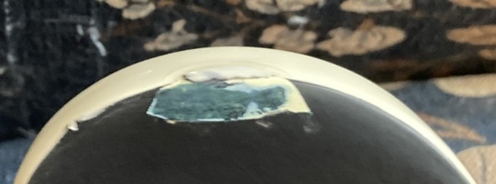

i started the filling on the outside (front) edge of the headstock. so far it's a qualified success, with a big qual. i filled the ding with white CA after spraying the spot with accelerator, and that shit is miraculous. dried glue that would usually take a couple of hours in seconds. the contouring worked out quite well, the colors less so. the white CA isn't opaque enough to hide the spots where the black infiltrated small imperfections under the masking tape. here it's sanded out to wet sanding with 2000 grit. i'm going to have to do something else to fix the coloration; the black lacquer marker will probably do for the black surface, but it's going to require some kind of off-white paint that can cover the black bits that lapped over the boundary. please have a Vintage White brush-on poly, thank you very much.
yeah, i know, not a great picture...try taking a end-of-headstock photo holding the phone in one hand and the neck of the guitar in the other. the things i do for content...
i'll polish it out tonight and probably do the black marker bits, which hopefully will cover enough that it won't require separate painting. i'll have to consider what to do about paint...i can't shoot lacquer over poly because it'll fuck it up, so i'll have to find some paint, ideally poly-based, that's opaque enough to make a solid shade. probably StewMac or one of the other luthierie emporia will have something.

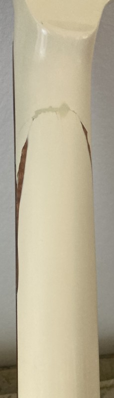

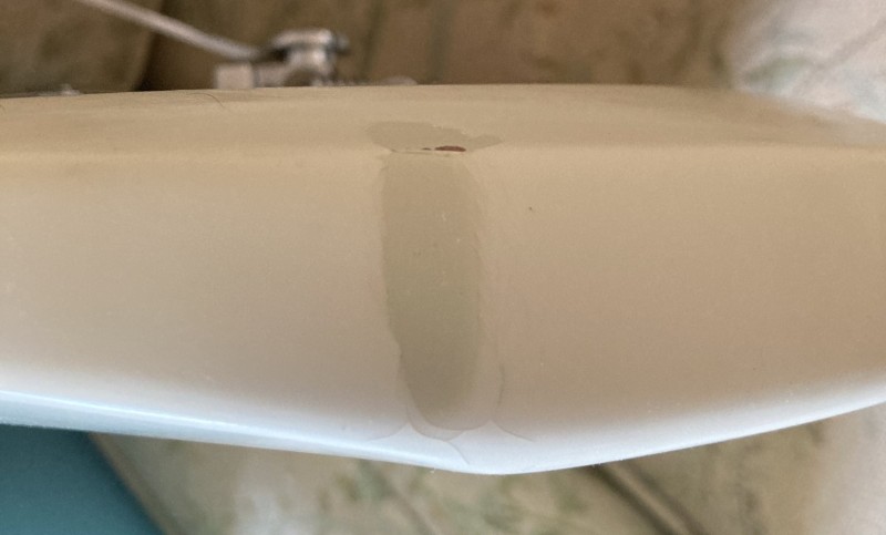

i went ahead and prep sanded the remaining problem areas on the Jetstar, the neck at the scarf joint repair and the ding in the left side. the new plan may simply be using the Vintage White acrylic to cover the damage, do some clear coat over it so it can be polished, and sand/polish. this could all be done over the weekend, which would be delightful. prep sanding with 800 was very helpful for the neck repair area, removing some cracked paint and taking everything down to a reasonably smooth surface to paint. i’m going to do the acrylic over the surfaces sanded to 800 because theoretically that should help the paint stick.
Posted: Fri May 30, 2025 1:44 am
by dubkitty
i’ll probably still use some CA for e.g. filling the areas where i sanded down the cracks in the original finish for contour. and i might try tinting the white CA to try and match the original finish. but i suspect that the end game here will probably involve acrylic Vintage White paint unless i match colors really well and the tinted CA suffices as filler. and i expect at least one of those conditions will not be met.
Posted: Fri May 30, 2025 9:22 am
by dubkitty
sanded the remaining trouble spots. i had originally hoped to infiltrate the finish cracks near the neck break with tinted CA and sand them to an acceptable result, but i think that would only make deposits of CA in/around the cracks i'd have to sand through. polished out the headstock complete with problem bits. i'll pick them up with paint later. you can see here that the neck separated pretty cleanly along the scarf joint. the body ding will be less problematic, i hope, assuming that i can either match the CA or get the Vintage White acrylic matte and clearcoat over it, which worked a treat on the Kondor body fixes. i should probably sand the area below the body ding to try to eliminate or at least deemphasize the cracks in the finish below the ding. timetable for finishing the rest could be this weekend, but given my life i wouldn't count on it. you can see here that the neck is absolutely mahogany or a similar species. have i mentioned how much i love mahogany slab guitars lately?

i was too tired to go to Walmart after craft paint so that aspect of things will be delayed. the next thing i’ll try to do is color-match the CA and use it and the accelerator to try and fill the side ding. the neck is kind of complicated…along with the stuff you see in the photos there’s also a substantial divot around the tang and end of the 2d fret that had been filled with paint or something, and about 4” of fretboard edge that lost its clearcoat, which had been cracked in the accident, when being sanded that
will need to be redone. i think i’ll try using the rosewood grain filler on the divot. the light color of the wood should work with the filler hue. whether i try to use the tinted CA on the neck or not totally depends on how well it works on the body ding.
