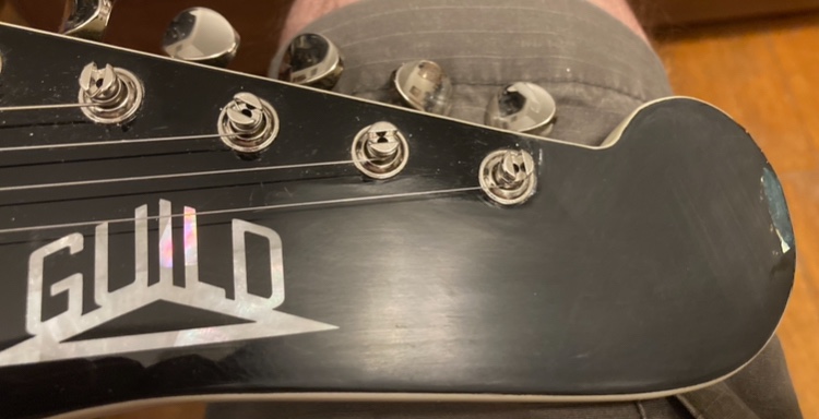

i sanded the end of the headstock face with 800 grit until it was reasonably smooth. i stull have a couple or three lighter weights to do before polishing so i'm not tremendously concerned about having it perfectly smooth yet. the CA is solid enough that it was tough to sand through the excess from my layers of glue, so i feel pretty good about it as a minor structural element. the biggest problem is that the glue dries to a blueish-grey that doesn't match the paint, but i can just go over it with the black lacquer pen. the light triangle happened somehow, i'm not sure exactly how. it's a vuisible defect only; you can't feel it when you run your fingertip across the surface. it'll also get touched up. there are a few places where the black slipped under the masking tape, but they'll either be covered by the white CA or scraped off with a blade. the actual edge looks reasonably consistent. i'm now a lot less worried about getting an acceptable result on all the damaged areas.

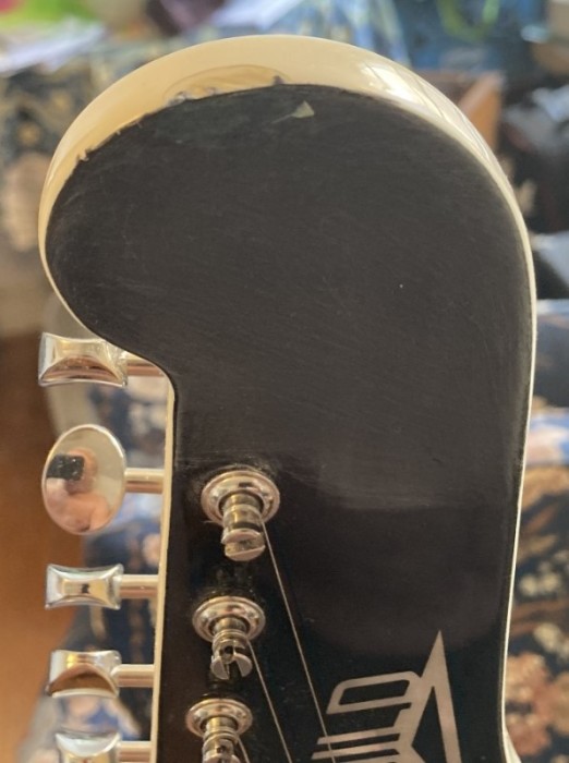

it's beginning to develop a vibe of its own. it looks ready to jump up and bite you. like Casper the Friendly Ghost's evil ghost nemeses. the replacement handle is more consistent with the design's Alternate Futures Of 1962 feel, while the round modern handle similar to a Les Trem was anomalously REAL-modern. the new handle makes it look more like something off a 60s Italian or British guitar.

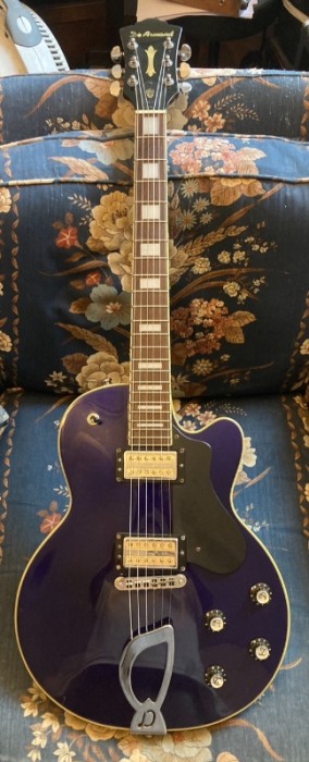

the current Jetstar thread is going to be derailed briefly by me getting the DeArmond M-75 that just arrived set up and in service. it’s generally in good shape, but there are a few minor issues that need to be sorted.
it’s literally the little/big brother of the blue sparkly DeArmond M-75T i got last year, in a Very Serious “Moon Blue” finish that’s almost black under indoor lights. the DeArmond Gold Tone pickups are the attraction here, a uniquely DeA take on a humbucker with a second row of flat polepieces leveled just below their apertures in the cover. they have more air in them than PAFs, and a POP to the pick attack that’s almost a DeArmond signature. when i cranked it up last night before destringing it and starting the cleanup/tuneup phase it sounded great, snd more importantly sounded like me.
there aren’t a lot of issues, but there are a few annoying little things. there are some deep scratches in a couple of odd places, two small dings on the edge of the headstock, and an area where the harp tailpiece meets the top that had 30 years of crud under the base that disrupted the finish a bit. the frets could stand a polishing but are in good overall shape. when it arrived the action was too low for me, but the guitar played without buzzes and rattles all along the fretboard indicating that the neck is reasonably flat and straight.
one irksome aspect is the knobs and other plastic parts. 3 of the 4 knobs exhibit some chipping around the upper edge; i hope to build those out with the black CA and strategic shots of accelerator. the toggle switch knob broke while i was handling the guitar for cleaning. i had spares in the parts box so it’s fine.
i need to decide whether to polish out the pick scratches on the top between the pickups that extend out an inch or 2 on either side, or just call it battle scars and move on. the pickguard is so scratched-up that i ordered a new one from Pickguardian…it was only $25 which is worth not having to spend several hours doing tedious hand work.
