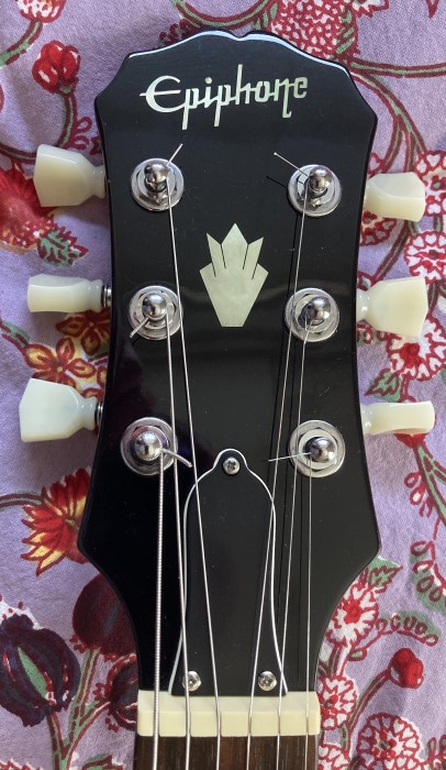

i'm not sure what i'll work on next. the Köndor has a fair bit of disassembly and drugdery involved, the Double Jet's wiring is still intimidating and i have to get the pickup mounts sorted, and the Hopf needs its fingerboard sanded and the aluminum pickguard filed and drilled to accept the larger Schaller single-coils. at the moment it seems the work/gain balance would be best with the Gretsch, but i have time to think about it. i'll have to approach the Kondor as a series of small projects that get reassembled at the end, so that'll pop up during/between other stuff when i need a break from what i'm currently doing. The Hopf is simplest conceptually: put on the correct neck, swap the pickups, add correct bridge, and Bob's your uncle.
and there's weird shit out there calling me. i'm watching a cheap acoustic on eBay like one i had in the 00s which i did my Acoustic Upgrade Package (horn/casein bridge pins, bone bridge saddle, nut if needed, improved tuners) on and used for altered tunings. i'm also developing a jones for weird mutant Fender designs built by Guyatone c.1970. i see shit on Marketplace or eBay and i'm like "PLEASE don't make me buy another guitar!"
FWIW you can improve any half-decent acoustic guitar 100% with the Acoustic Upgrade Package, especially less expensive ones. if you just do the saddle and pins that's most of the improvement.

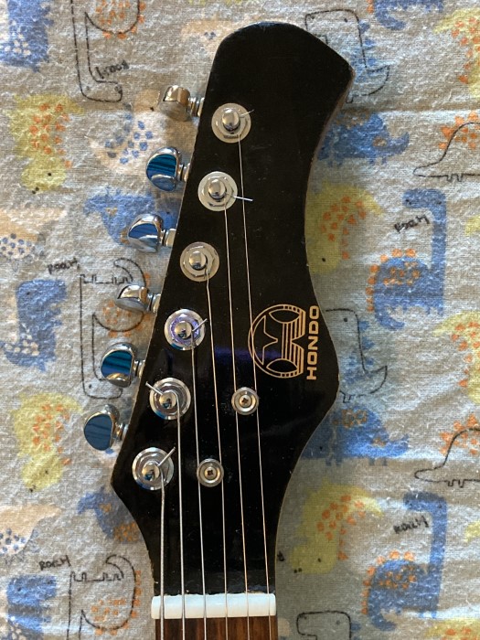

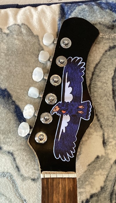

i also got the Kondor's headstock fairly well sorted. i stopped off at an auto parts store the other day and got some finishing products i've used in the past for DIY guitar stuff. i went over the face of the headstock with liquid polishing compound. i'd forgotten how much compound, force, and time are required for a result, but in a reasonable amount of time it was looking almost frighteningly glossy. i found a California condor sticker on Etsy that barely fits on the headstock, but i rather like the bold effect.
kondor headstock.jpg (93.45 KiB) Viewed 4738 times
compare to February. the new tuner buttons are from Hipshot, and i was very happy to find a pearloid option for mini tuners that wasn't a Fender, Grover, or Schaller clone.
kondor head.jpg (142.56 KiB) Viewed 4738 times

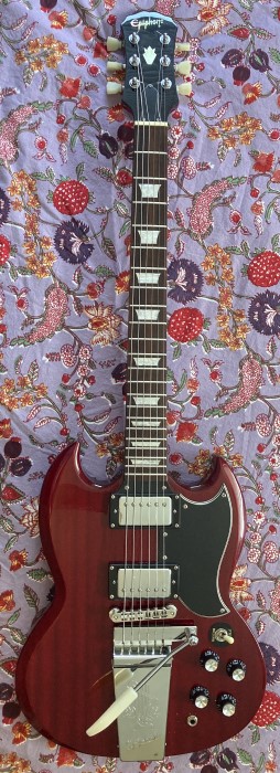

one tiny thing that's coming up will be installing pearloid Hipshot keystone tuner buttons on the SG's Grover tuners. i think they'll look more metaphysically right than the kidney-bean Grover buttons, and will be the last vintagizing thing i can do to its appearance short of throwing it down the stairs. i used the polishing compound on the truss rod cover which improved it a lot.

project momentum is picking up. starting with the small stuff, the Hipshot keystone tuner buttons for the SG arrived. they don't quite exactly match the vibrola knob, but close enough that i don't care. had to leave out the teflon spacer washer so the buttons didn't stick out too far from the headstock. i find it striking how much more balanced the design is with the original style of buttons and the other small changes. i'm really not trying to fool anyone into thinking it's anything it's not...my changes are on a subtler level, trying to making it look right. that "SG" on the truss rod cover in particular always bugged me. i don't see anything left to do here, except maybe put in a US pickup selector switch because the import ones suck. people diss the Epiphone humbuckers, but they're fine if you adjust them carefully.
SG 7-8-24.jpg (89.82 KiB) Viewed 4533 times
SG headstock 7-8-24.jpg (99.91 KiB) Viewed 4533 times

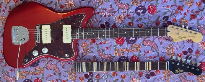

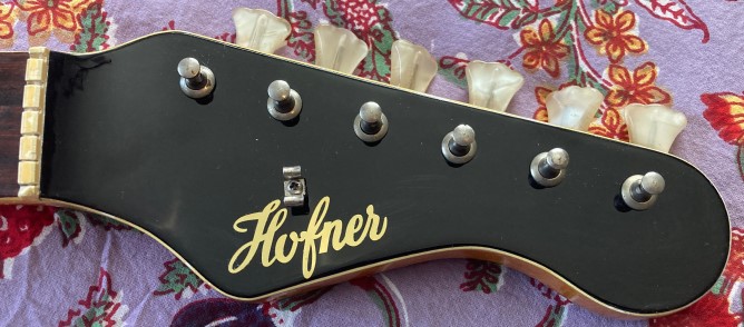

that Sunday project was working on the Höfner Galaxie neck that's been on the Hopf Twisty body; since i got the correct Twisty neck the Galaxie neck is looking for a home. it's the same scale as Fender bodies, so i ordered a Fiesta Red Jazzmaster body from GFS. i'll need to modify the neck pocket because the Galaxie neck has a squared-off heel like a Telecaster and is one fret longer than a JM neck. i spent a fair while polishing the headstock. i started with polishing compound, but had to go back and sand out some scratches with 1200->2000->wet sand w/2000 and then polish, polish, polish until it looked good. to do this i had to take off the tuners, so i disassembled them, cleaned them, and shot some dry lube on the works before reassembling them. i had hoped to be able to get the worm gears out because a couple of the key posts are slightly bent, but they're brazed into place so i'll live with it. if it really bothered me new replacements in that style are available. i found a laser-cut metal foil Höfner logo on eBay to replace the missing one. it was tricky to position because i couldn't find an exact example of another one with the string tree in this position. it's a bit too close to the edge, but it'll do.
Hofner neck 7-8-24.jpg (46.83 KiB) Viewed 4533 times
the M-75T wants to be this shiny.
Hofner headstock 7-8-24.jpg (66.29 KiB) Viewed 4533 times
note difference in fingerboard length.
Hofner and JM necks 7-8-24.jpg (94.3 KiB) Viewed 4533 times
this will be the home of the three Höfner 511 pickups i have, two of which came from a Kapa guitar off eBay a decade ago and the third of which i got more recently. i need to get a multimeter so i can measure the impedances and put the hottest one in the bridge position. since one of the pickups and its mounting bracket came separately, i have the option of rotating the neck pickup 180°from normal orientation so the staples are at the 24th-fret harmonic. i plan to do some oddball Galaxie-inspired wiring tricks...i'll do individual thumbwheel volume controls and on/off switches for each pickup in a Höfner stylie, and put the tone switch from the Hopf Jupiter 62 pickguard more or less where the Fender pickup selector normally goes. the lower pickguard gets master volume and tone controls and the 1/4" output jack. i'll probably redraw that part of the guard for a rounder, more German look; the left upper bout part of the guard will be deleted. i'll get Pickguardian to do the guard, and perhaps send examples of the controls so he can get them just right.
so when the JM body arrives i'll drill the neck bolt holes and set it aside pending getting the control parts and ordering the pickguard. i plan to use the leftover Musima bridge from the parts box, and hopefully the Hagstrom-clone Musima tremolo as well if it adequately covers the tremolo rout. since there's no bridge stud holes drilled in the GFS body (it only has the electronics routs) i can use the bridge which has a broader-than-normal stud spacing.

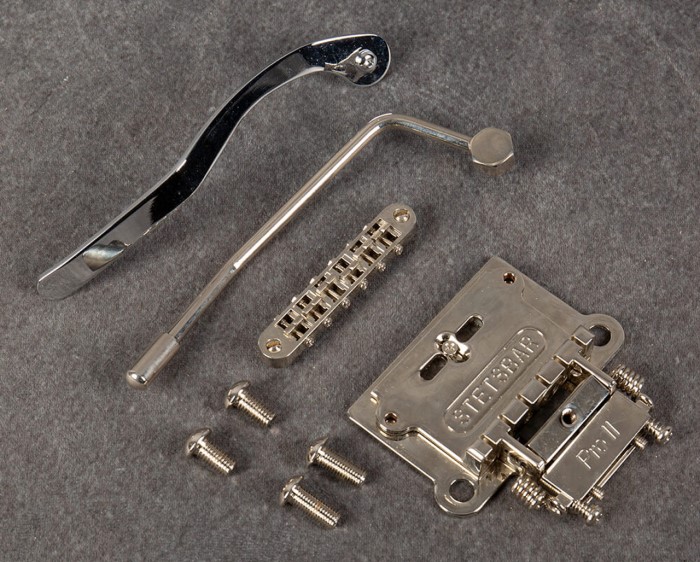

but i thought you were going to use the Hagstrom tremolo on the Jetstar? yeah, but i found something even better. allow me to introduce the Stetsbar tremolo bridge/tailpiece...it's a surface-mount that uses standard Gibson-spaced stop tailpiece mounts and is based on a plate that pivots with the tunomatic-style bridge attached to it. apparently you can dive-bomb with it and everything, which isn't really part of my aesthetic but adds another possibility. a nice bonus is that i won't have to do anything to the Jetstar other than pull the bridge studs and screw it on, which i like because it's already going to be more work than any of the other projects. and it has a cool chrome industrial look.
Stetsbar tremolo demo video

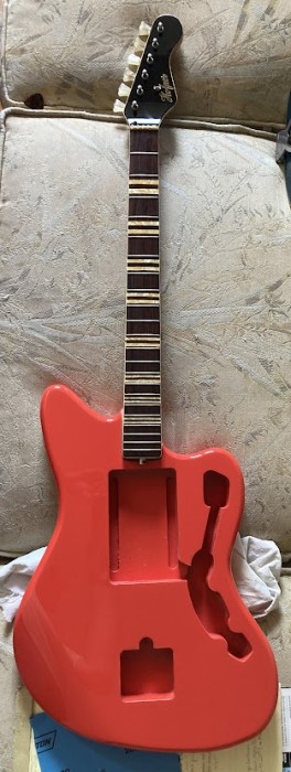

the body's here. i got it out of the box and laid it out on the sofa with the neck.
GM neck and body.jpg (57.95 KiB) Viewed 4256 times
as noted i'll have to essentially bung out the back of the neck pocket to make room for the extra fret, though arguably i could just square out the corners and leave it because there's nothing drilled for the bridge so i could have it be 1/2" closer to the neck. i'll think about that. the pocket will have to be shimmed on the sides because the heel is narrower than Fender spec. i'll have the pickguard cut to cover the shims which i'll trim down to the height of the top.
the color is odd...it's more orange-pink than any Fiesta Red i've ever seen. i don't love it, but i can live with it. i reminds me of the dish i learned from my first wife, mashing up and melting cream cheese in tomato soup and blending it. it's particularly curdled-looking in the dim sunlight from the overcast skies and looks several shades lighter than the photo. i'll definitely have to sand and buff it out...the paint job is decent but a bit orange-peely. i might skip the final fine polishing though...i'm not sure this shade needs to be brighter.
the Hagstrom tremolo is way too small to cover the tremolo rout, so it's back to the drawing board there. i'd like to find something more interesting than a bog-standard JM trem, but that form factor seems to be what will work. i could get a 60s Schaller trem like the one on the Twisty, but i'd prefer not to spend $200 if i can help it.
so now i have to establish how much space there is for pickups and electronics, and figure out how i'm going to lay out the controls. i'm glad i chose a JM body rather than a Strat which was the other option. i think it goes with the Galaxie DNA better.

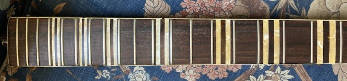

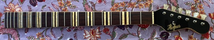

speaking of sanding, i decided to try evening out the fingerboard inlays on the Höfner neck, which are made up of pearloid binding strips on either side of a tortoiseshell binding strip. since the celluloid shrank at different rates, this made some of the strips thicker resulting in an uneven, horizontally-ridged (i.e. parallel to the frets) surface. first i tried using a small file to reduce the worst offenders at the high end of the neck which were tortoise strips, but i wound up doing the whole inlay areas because i noticed that as i took off surface area the pearl became less yellowed to the point that one strip particularly stood out. and since i wanted it to look balanced, that meant going in and totally flattening all the inlay areas with files and sandpaper. it loses some of the antique effect, but i think it looks better. it's also a much better surface to bend a string on because there were surface irregularities in the strips which are now smoothed. now i'll have to fix the wood parts of the board, too, or they'll be too rough compared to the inlays. dammit. here's how the highest four look compared to the un-sanded ones to the left.
hofner markers half sanded.JPG (45.45 KiB) Viewed 3953 times

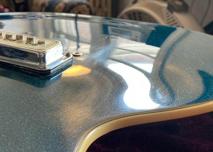

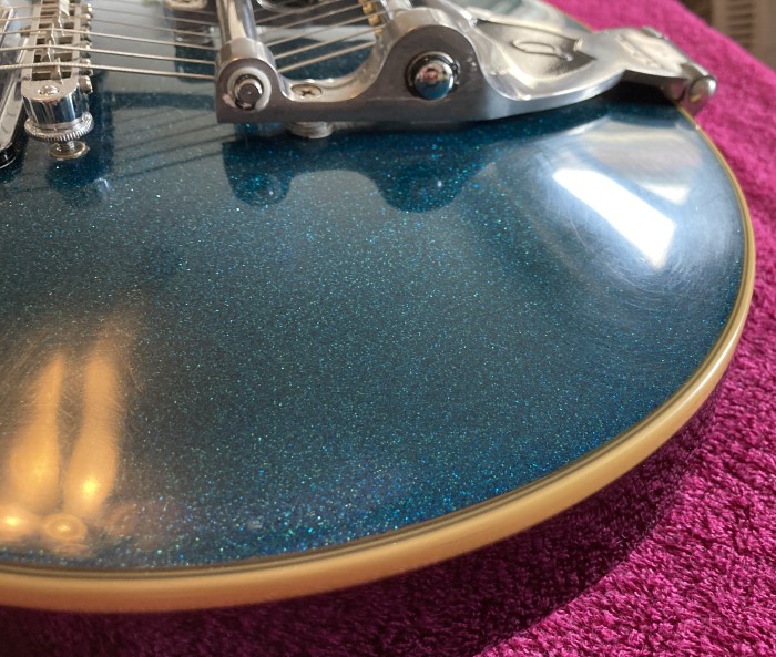

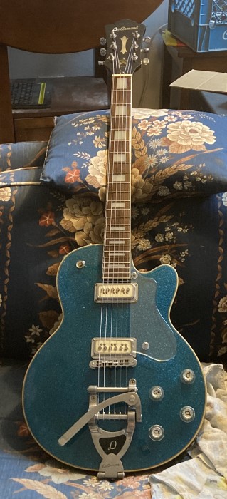

here's a couple of examples of the improvement in the M-75T's top after polishing. compare the reflective area in the middle to the heavily swirled areas around it.
dearmond blues 1.jpg (136.19 KiB) Viewed 3953 times
dearmond blues 2.jpg (83.8 KiB) Viewed 3953 times

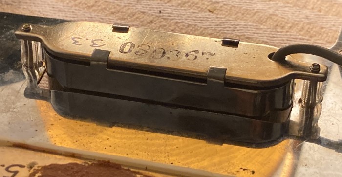

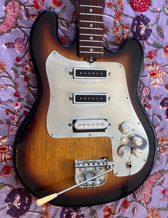

i needed thick clear plastic tubing for the M-75T's pickguard so i hit up my girlfriend, who uses supplemental oxygen at times and as a result has a ton of tubing of various diameters. i twigged that this was the solution to the Kondor's problem with the pickups being unsteady because the springs weren't right for the job. remembering i'd seen Strats with tubing for springs, i cut some short-ish pieces and they work way better. the pickups barely move at all, even though the opening for the bridge pickup is much larger than the pickup itself.
Kondor pickup supports.jpg (65.65 KiB) Viewed 3953 times
i intend to do wiring work next, first finishing the Kondor so it's playable again and then working on the Gretsch wiring harness. but in the near future i'm going to take a bit of a break...i've been doing so much project work that i'm hardly playing through the setup i've just about perfected, and the literal Guitar Of My Dreams will be delivered sometime soon at which point i'm dropping everything but my girlfriend and my cat while we get to know each other.
