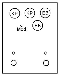

Actually, what the hell is the 3rd knob doing on the EB side????
Re: Devistortion clone build
Posted: Wed Jul 06, 2011 2:10 pm
by jfrey
chutneyfarmer wrote:Actually, what the hell is the 3rd knob doing on the EB side????
It's just a different layout. Two knobs each, and one mod switch. Like so:
Awww, I see now, duh :) dying to see and hear how you get on with this! This has been on my ever-growing to-do-list for a while now
