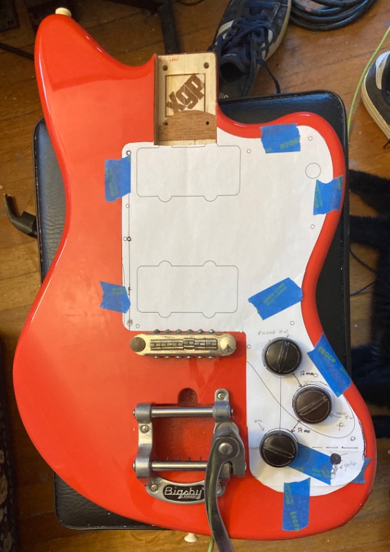

then it was time to work on the pickguard template, because i needed to know where the relocated controls would go before chiseling out the cavity. i think i got a good outline for the control area; the final strategy was to follow the outside edge of the body beyond the normal end of the pickguard and then turn in fairly gently, making a shallow curve for the end of the guard which i adapted from one of the body’s curves by doing a rubbing and converting it to a drawing. this was my third try at doing the lower bout, and i think it’ll work with minor adjustments.
i used the RCA knobs to figure out the spacing, which is subject to change based on the dimensions of the switches which are larger in diameter than the knobs. i need to make a few corrections, particularly adding back the bump at the left side of the neck pocket and about 8-9 mm of pickguard height so the sides match. i based the concept on one of the Höfners i posted upthread which had a similar configuration.
i haven’t tried to draw in the pickups yet, because i kind of need to put at least a string or two on so i can place the bridge and neck pickups in their sweet spots, especially the neck which really needs its polepieces right at the 24th fret harmonic. old Höfner solidbodies tended to put the bridge pickup as close as physically possible to the bridge, but i didn’t want the pickguard to extend under the bridge so i left a few mm of space.

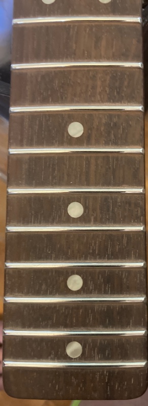

i sanded the first 2 frets with 1000->1500 grit and am quite pleased with the results. i don’t really see the point in polishing fretboards any finer than that because they’re going to have strings scraping across them. here again you can see the filler on frets 3 and 4, and how it disappears into the background once it’s oiled.

on reflection, i decided that laurel really needs to be polished down to 2000 grit to look good…it was still a bit dull compared to rosewood, and the extra work made it much better.
i also managed to install the string ferrules in the back without any obvious fuckups. they did not precisely fit the body regardless of claims by GFS, so i had to ream the apertures with a hand-held drill bit. using a powered drill would generate too much torque and take paint off in chips. that wasn’t too much trouble, but unfortunately the lips around the outside of the ferrules doesn’t fit the countersink either, and i’m not getting into hammering them in. so they stick out.
i also finished the fingerboard, whose figuring is nicer somehow than the usual variations in other woods that irk me so. the lighter parts are slightly translucent, which makes it light up in bright lighting.
