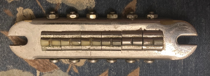

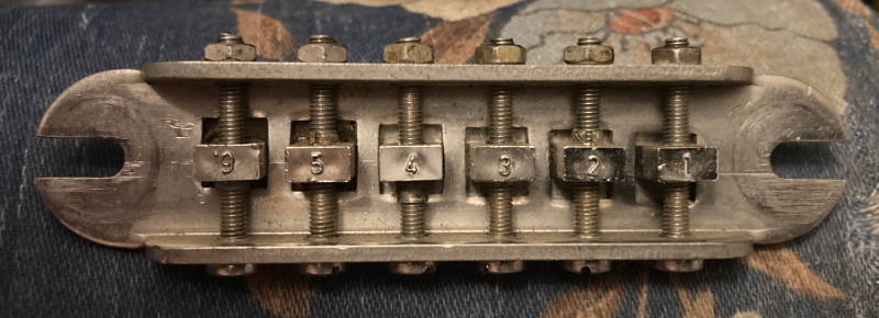

i knocked out one more small Galaxiemaster job, fixing up the Musima bridge. a couple of the bridge saddles were wonky…the plastic saddles work with metal adjustment screws via wee brass inserts of very thin metal, just this side of foil, that the screws bite into. you can see the end of one of the bushings protruding slightly above the upper edge of the 2d and 5th string saddles (helpfully labeled “2” and “5” respectively on their bases) in the second photo. the bushings were missing from two saddles. fortunately i have a second Musima DeLuxe bridge in poorer condition i got with a heap of funky parts from a guy in Poland, and was able to pull the bushings and transfer them to the other bridge’s saddles. once that was done i needed to fix the lock nuts on the ends of the screws in place so i hit them with blue threadlocker and after drying they rotate freely with the screws without coming undone. my favorite blue threadlocker use is securing the nut that secures the output jacks on many guitars which can have an annoying tendency to come loose, letting the jack fall into the interior of the guitar. my 335 was very problematic that way until Loctite entered my life.
the Musima bridge, like many East German parts, is crudely made (compare to USSR parts where the prime directive seems to have been CHEAP AS HUMANLY POSSIBLE) but has a wide range of saddle adjustment that’s pretty detailed due to the closely-threaded screws. it also goes with the general weathered look of the neck, Bigsby, and RCA K-80 knobs. i need to decide just how to use it. the best solution that doesn’t involve drilling stud holes is the Göldo (yes, the umlaut is correct…the founder is Deiter Gölsdorf) multi-width base which can go wide enough for the wide-spaced bridge. it also has handy plastic foot tabs that would serve as decent mounts for the putative Oyster pickups, which come in a pre-wired pair with a single output jack. they might not be dreadful run through the Hotone Acoustic Simulator which could also serve as a preamp of sorts, and really what more could i ask for in a cheap piezo solution? they’d probably do better either literally stuck onto the bottom of the bridge or on the top of the body near either end of the bridge, though.
