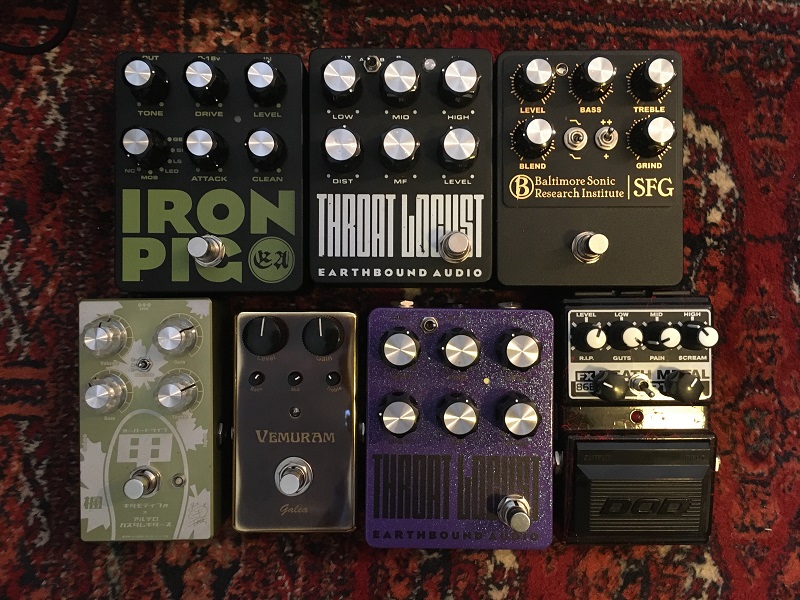

Here my contribution to this topic, maybe not as deep and detailed as Dowi, but when available with my demo vids.
Earthbound Audio Throat Locust
This is the King my distortion pedals, I love it so much that I got a second one at some point!
As you already know this one is EA take on the HM2 topic. I used to have few other HM2s iterations over the years (BYOC Swede kit, KMA Wurm, Fuzzlord HM6, Arion Metal Master), but to me the TL has few features that set it apart from the original and all the other clones/derivates: the parametric mid control and the clipping switch (which I though few times to replace with an on-off-on to have also no-diodes option, but so far I’m really happy with the stock pedal).
With these controls you can achieve a huge array of textures and sounds, as already well pointed out by Dowi.
I love the Low control on this one, I have the feeling is tuned way lower than a standard HM2, so you get a tons of subbass frequencies being pushed. And in general, I always felt EA pedals are tuned to allow all the low frequencies to pass thru untouched. Simply put it’s HUGE sounding device at any gain setting.
I have 2 of these: a 2018 made and a 2020 one. The 2018 inside has a trim pot to set the full gain available, which I eventually set to achieve higher gain possible. I rarely use it with maxed out gain, but it's nice to have and this way it has a bit more gain available than the 2020. Also (but it can be due to component tollerancies) the 2020 has a slightly wider mid frequencies sweep range.
DOD FX86b Death Metal
I think this pedal doesn't need a big introduction on this forum... got this one for cheap from a local seller (whom I think he didn’t have a clue about how sadly and madly hyped these got nowadays). Before this one I used to have the Digitech DDM, which is the same pedal, but this DOD allowed me to fine tune some components as you can see from the family picture below. I added a clipping switch (silicon or LED), a gain control and a mid freq knob (yes… the concept is loosely based on the Throat Locust), and fine-tuned few components to allow more low-end.
This is the perfect distortion for synths and noise machines. The 3 band EQ is very effective and powerful, plus with the added gain knob you can go from a slight clean boost/overdrive up to a brutal wall of harshness (I used a pot value way higher than advised, so the pedal can easily self-oscillate, if needed).
Earthbound Audio Iron Pig
Another EA pedal: I love this brand (I also have a Supercollider, but being a fuzz I didn't include it in this list). This IP arrived yesterday so it’s still fresh to me, but so far I love it. It's EA take on the RAT, and a very well made one indeed!
IP covers all those classic RAT tones, and more, thanks to the Attack knob and the clipping selector. Of course, being an Earthbound pedal, so you get the EA’s low freq tuning. The gain range is very wide, and goes from slight overdrives/clean-boost up to sludge-doom mayhems.
It has a clean blend, which can be very handy in many situations. Actually, I grew quite fond of distortion devices with clean blend lately, it's very useful feature indeed, not only with bass and synths but also on guitar (especially when stacking more gain stages together).
BSRI Audio SFG
If the Iron Pig is a vintage RAT, the SFG is a very modern one. It has a 2 bands active EQ, a tightness switch (it's a bit like the Attack knob on the IP, with 3 fixed settings) and a very cool clean blend with a switchable lowpass filter (3 positions: off, high-cut 1kHz, high-cut 100kHz).
The clean blend is amazing as it lets you decide which part of the spectrum is blended and unlike most blends, Dist Volume and Clean Volume are 2 totally independent controls, so you can also use the SFG as a clean booster!
The distortion is very focused and on the bright side, but the 2 bands EQ can tailor the sound quite easily, going from nasty and acid (high knob fully open) to wooly and smooth. When I first got it I was amazed how this distorts bass/low/subbass so well (thru the years and experience I learned how many guitar pedals are not designed to handle line levels and full frequencies ranges, and most tend to cut frequencies, especially in the lower range, or will "implode" if feeded with line levels). This SFG was designed with bass in mind, so it retains very well all those low frequencies.
I mostly use this pedal when I track bass: I fake it by using my baritone guitar into a Digitech Drop (1 octave down setting) then into the SFG, set with the 100Hz LP cut on the blend and a mild distortion setting: very effective!
Altero Kaede Overdrive
I wasn’t so much into overdrives until I got this one. Kaede is the signature OD pedal by Kida Motifour, the lead guitar player of Japanese post-math-rock-pop band Tricot… That was my first reason why I got it, as I’m a huge fan this band. But after getting the pedal, I discovered that I love the Kaede so much!
It is a low-gain OD, that can be set to be very transparent and clean or can be pushed into light distortion as well. In the middle there’s a 3 ways headroom switch (low-mid-high), which set the compression/clipping/brightness of the OD (I mostly use it in the Mid position, low is more compressed and dark, while high is less compressed, open-sounding and has a bit more output volume, perfect for clean boost duties). It basically covers all this kind of tube screamer/boss SD1 tones, but I love that Kaede has a very smoky flavor: it is actually a dark-sounding overdrive, to really make it bright you have to set the high knob higher than 3 o’clock, as I think it was designed mostly to be used with single coil pickups, but I like a lot also on baritone guitar, neck pickup and there's a bluesy mojo going.
Another positive discovery with low-tunings and synths: it retains very well all the low-end frequncies, also with the bass control set to zero, so this is another those huge sounding drive pedals!
Vemuran Galea
After the Kaede I got a Galea. It’s basically a mid-gain overdrive, with 3 bands EQ (designed to sound like a pushed fender amp… whatever, it sounds good to my ears), and 2 trim pots in the back to set overall gain available and EQ saturation. I use it when I need a bit more gain and mid grind/presence than the Kaede. It doesn't get so much use lately, but t’s a quite flexible device, sound/gain-wise a good link between the Kaede and the Iron Pig.

Oh yeah, I bought a Rare Buzz Snitch, which is their take on a Rat. And so I've arrived at the fact that I quite dig rats, but they are best at the high gain hard rock sound and not metal. I stacked it with both the Surveyor and the Piccolo, and definitely got the chugs going on, but I needed a noise gate, there was so much hiss. Anyways, this pedal has crazy output, lots of gain range, diode fun, insanely nice build, and priced to move. So if you're after a rat just snag one.
What else? I bought a klon. Bought a Mosky golden lady or whatever it is called, mostly because I was 100 kronor from free shipping and the pedal only cost like 270 so why not. I kind of bought it as a joke, both the fact that it was stupidly cheap, and that it was a klon. But I'll be damned. Klons are worth the hype. From what I understand these are fairly close to the original - close enough for a joker like me anyway. And it sounds great. Most of the settings sound really good, and the gain range is decently wide. It has a wee bass cut/mid hump which is good for goosing stuff, but it sounds awfully good on its own too. If it wasn't for the fact that I went silly on the all black pedal board this would potentially be my low gain overdrive, or hell, two of them. I think anyone who is interested in low gain sounds should check one of these out.
I also went on a bit of a DOD 250 bender, inspired by DoS and Coldbright. So I bought a 797 from Dirty Haggard Audio because it was cheap as chips, mostly black, and the description was pretty cool. With my Nelson it sounds like a DOD 250, but with my higher gain pickups in the V it is never really an overdrive - it's always more or less distortion. Two knobs, good build quality and gets pretty distorted. The basic tone of the 250/dist+ circuit is just really good in my ears - works good on low gain (a bit tweedy/small fender working too hard) and it sounds really rock n roll when you turn it up. If you're after a straight up 250 this isn't gonna do it, but if you want a really nicely voiced 250 style circuit that can get pretty heavy then do it! Goosed with a hotcake it gets really heavy too, but then you need a noise gate.
I built a DOD250 from Musikding - grey version. The low gain is much lower, even with my V. I like it so much it's now on my board. I breadboarded a version with some mods and I dug that as well, but I've gotta get some skills and make a pcb for it. I've got the handwritten schem above my computer right now, but I just don't know enough about electronics for this to be a task I'm going to look forward to. Maybe next summer and I'll do a few protos. Swapped the diodes endlessly until I found a shottky/LED combo that was fun. A good mix of tightness and hair. Bigger input and output caps, bumped up power supply filtering, and stole a thing or two from the dist+ and rat and put a smoothing resistor on the shottkys. Completely unoriginal and sounds very nice, so I really want to make a couple and test em loud.
