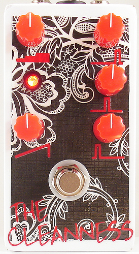

this is the finish on mine:
The Flourishness.jpeg (141.72 KiB) Viewed 4964 times

That finish is awesome! Sounds like some great ideas in there. I love the idea of getting lofi radio type of sounds out of this, and it really would be fun to throw this after my Cream Puff, original Fender Blender, or original Swollen Pickle, just to change the character. I guess the name is somewhat misleading. I have to stop thinking of it as a clean boost, and start thinking of it as an EQ pedal with some gain added to it haha.
